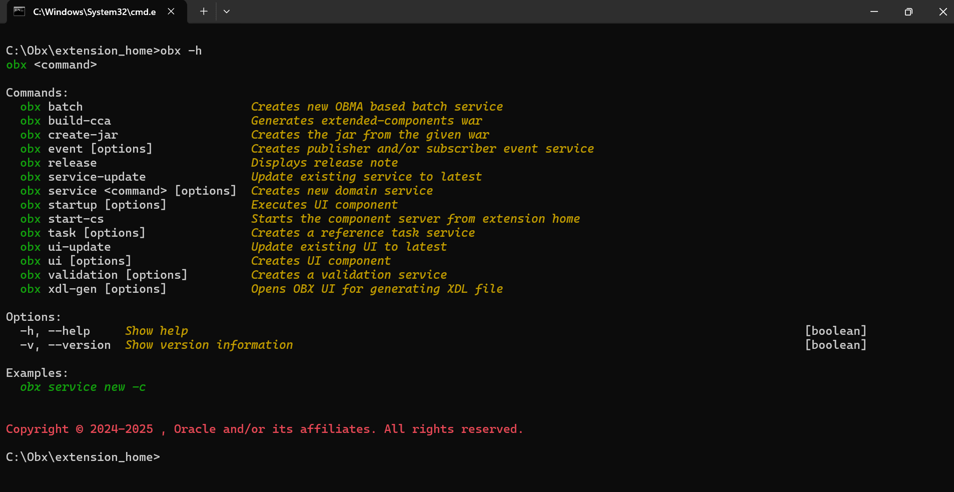

It is assumed that before setting up OBX for generating the first artifact, all the installation process is completed till extension_home folder creation and user are able to see the help menu like below:

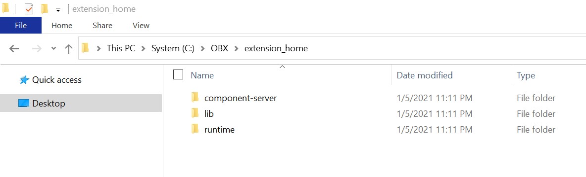

    After all the above process extension_home folder looks like below.
    Figure 1-5 Extension Home Folder
