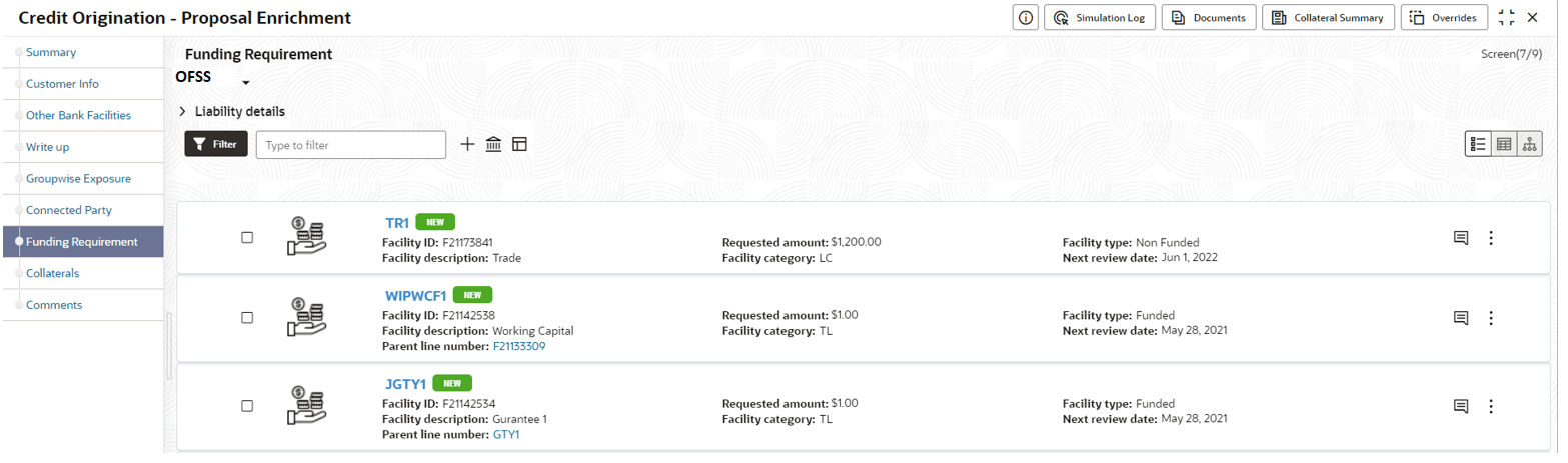

4.6 Proposal Enrichment - Funding Requirement
This topic provides systematic instructions about the funding requirement.
This data segment allows you to modify the facility details added in the Initiation stage as well as to create new facilities.
  1. Click Next in the previous data segment to proceed with the next data segment, after successfully capturing the data.
    The Funding Requirement screen displays.
    Figure 4-53 Funding Requirement
    All the field columns in facility details are configured in Business Process screen and the derived fields are displayed in Funding Requirement screen. For facility details, maximum coloums allowed to add is 10.
    For more information on business process field configuration, refer to Field Configuration Sheet
  2. Click the action icon in the required facility record and select Edit.
    The Funding Requirement - Facility Details window is displayed.
