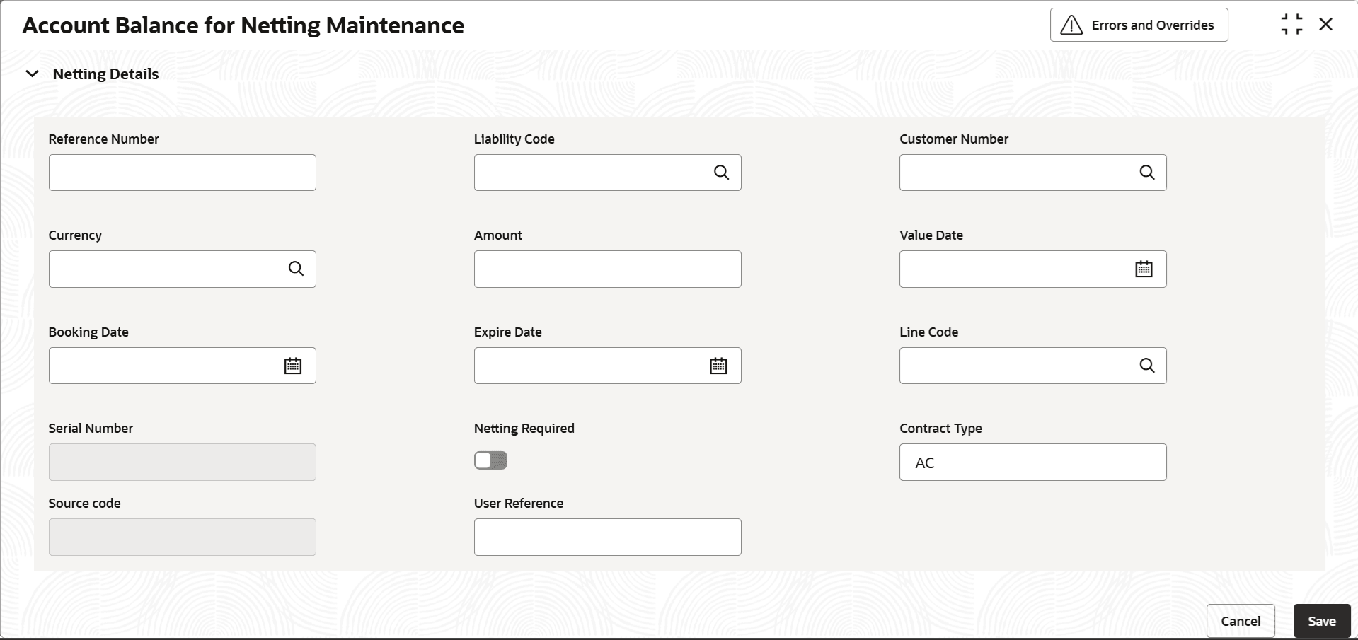

    The Account Balance for Netting Maintenance screen displays.
    Figure 2-49 Account Balance for Netting
  4. On Account Balance for Netting screen, specify the fields.

    Reference Number Specify the reference number, which is the account number or the contract reference number for which the balance has to be considered.
    Liability Code Click the Search icon and select the liability code for whom we are fetching the account.
    Customer Number Click the Search icon and select the customer number linked to liability to which the account belongs.
    Currency Click the Search icon and select the currency based on which the balance amount of the account/contact has to be considered. Once authorized, this entry will become non-amendable.
    Amount Specify the account/contract balance amount for netting.
    Value Date Specify the date from when this account/contract is valid for netting.
    Booking Date Specify the booking date on which the account/contract was created.
    Expiry Date Specify the date till when this account/contract is valid for netting.
    Line Code Click the Search icon and select the line code for the account/contract. This is required only when the netting balance is to be associated with a facility.
    Serial Number The system displays the Serial Number for the line chosen in the field Line Code. The Serial Number field is disabled and it gets defaulted from the Facilities Maintenance screen.
    Netting Required Select this check box to indicate that the netting amount defined in the Account/Contract Balance for Netting screen is updated in the Netting Contribution field for the specific facility for which Netting Required check box is selected. You can have the Facility to display the Netting Amount in the Netting Contribution screen.
    For more details on this feature, refer the Including Netting Amount in Facility’s Netting Contribution topic in Enterprise Limits Management User Manual.
    Contract Type By default, the Contract Type field displays AC for the account netting facility.
    If the account is a Term Deposit account which you wish to link as collateral to a collateral pool,then specify a Contract Type other than AC like TD. Here you need not specify the facility code.
    For more details on linking Term Deposit accounts/contracts as collaterals, refer the Collaterals Maintenance topic in Enterprise Collateral Management User Manual.
    Source Code Specify the source code for the account netting facility.
    User Reference Specify the user reference for the netting facility which will help you to reference easily later..
