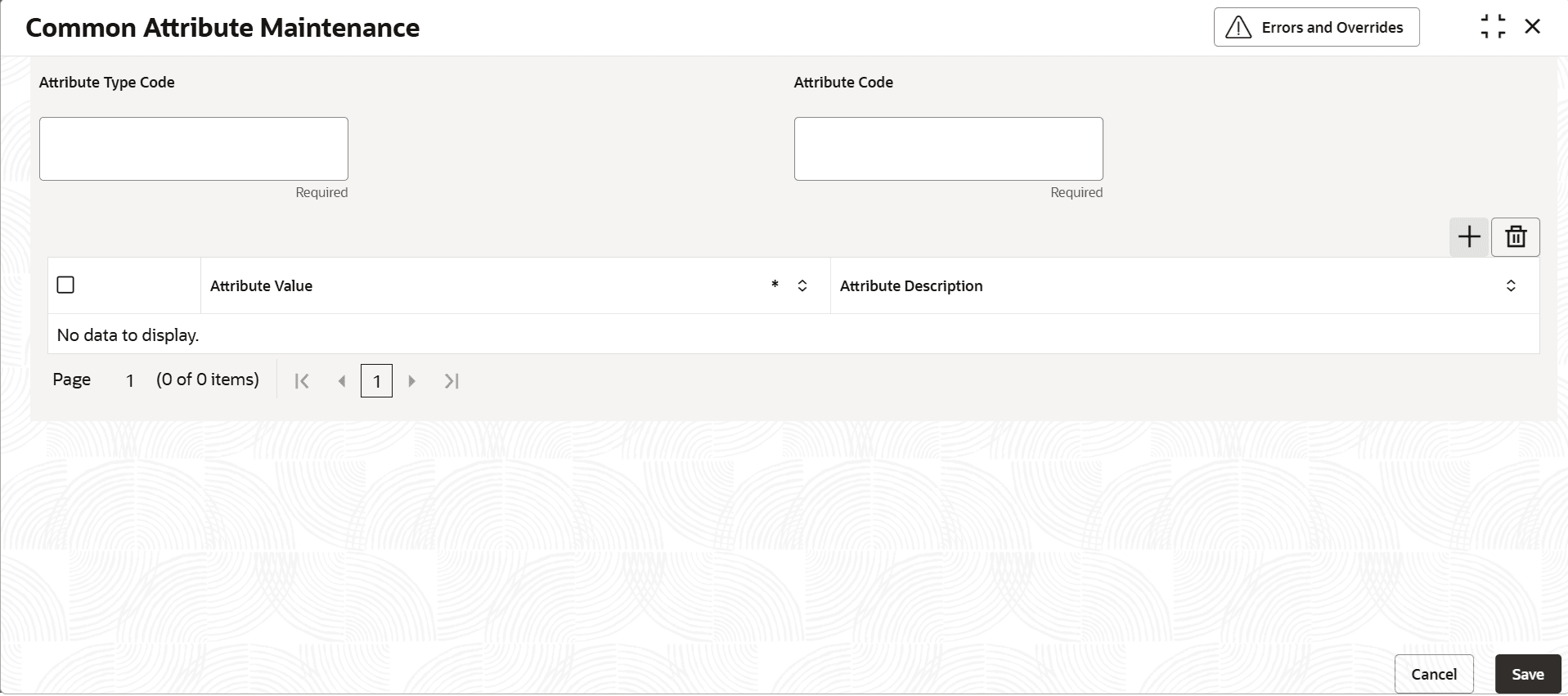

    The Common Attribute Bulk Maintenance screen displays.
    Figure 2-16 Common Attribute Bulk Maintenance
  4. On Common Attribute Bulk Maintenance screen, specify the fields.
    Table 2-12 Common Attribute Bulk Maintenance
    Field Description
    Attribute Type Code Click the Search icon and select the attribute type code. The parent or umbrella category under which multiple attribute codes can be grouped.
    Attribute Code Defines a specific reference type within the Attribute Type Code. For example, Region could be an attribute code under a broader type.
    Attribute Value Specify the attribute value for the code.
    In case of exposure code maintenance, you must specify the exposure codes here. Exposure code for exposure type Sector specified in Attribute Code field can be,
    For example, Mining, Agriculture, Transport, and Health.
    Attribute Description Specify a brief description for the attribute value.
  5. Click Save to save the record.
