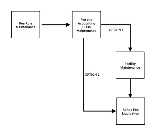

    • The two options can be summarized as below.
    Figure 1-91 Processing Flow Chart
  • OPTION 1 - Via Facility – In a scenario where you have to communicate in advance to customer on applicable adhoc fees,

  • OPTION 2 – Direct - In a scenario where where bank wants to collect an adhoc fee as and when required but with no upfront communication to customer and thus does not requires the adhoc fee to be linked at facility level.
    • This can also be necessitated because a new adhoc fee needs to be collected against a facility.
    • In this case, adhoc fees could be merged into a separate class called as adhoc fee class and you would not link that fee class to the facility.
    • Post creating the fee class, you can navigate directly to Adhoc fee maintenance screen to perform adhoc fee liquidation.

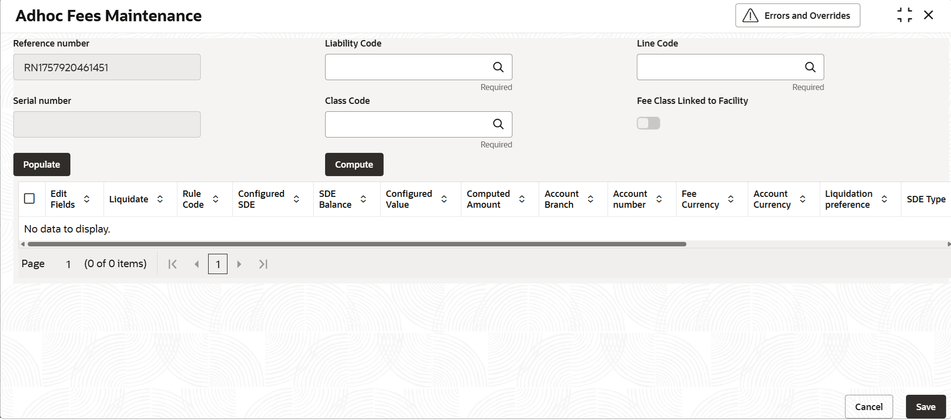

    The Adhoc Fee Maintenance screen is displayed.
    Figure 1-92 Adhoc Fee Maintenance
    • Each adhoc fee maintenance record is identified with a system generated UNIQUE REFERENCE NUMBER.
    • Select the liability and Facility id (line code) for the selected liability.
    • Based on the facility selected, system defaults the associated fee class and a non-modifiable flag Fee Class linked to Facility will get selected – OPTION 1
    • You can modify the defaulted fees class and select the fee class that not linked to facility – OPTION 2
      • In above case, the flag Fee Class linked to Facility will not get selected.
    • You can then click on the populate button to fetch and default the details of linked adhoc fees rules to the opted fee class.
    • You can then select on or more of the adhoc fee rules for liquidation – liquidate flag as Yes or No.
      It is not mandatory to enter the values for an adhoc fee which is not opted for liquidation – Liquidate flag is No.
    • SDE balance column will get defaulted which will indicate the underlying SDE balance at linked facility.
