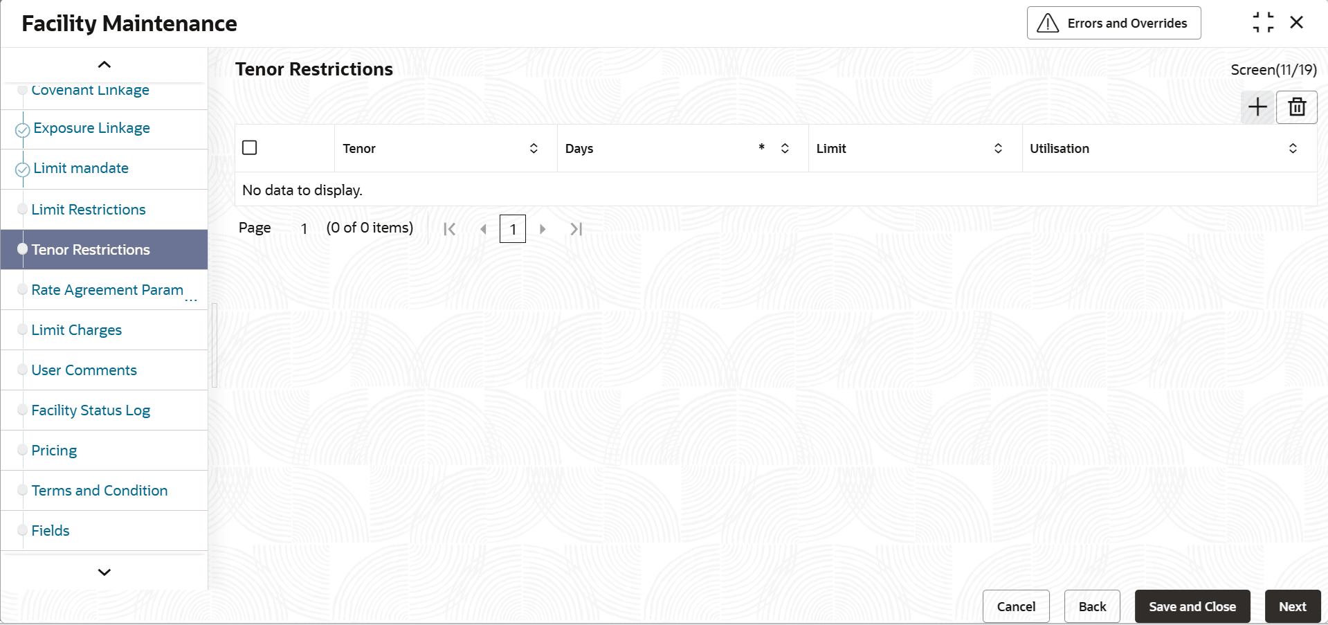

  1. Click Next in previous data segment to proceed with the next data segment, after successfully capturing the data.
    The Tenor Restriction screen is displayed.
    Figure 1-34 Tenor Restriction Details
    Table 1-39 Tenor Restriction Details - Field Description
    Field Description
    Tenor Specify the name of the tenor.
    Tenor (Days) Specify the number of days for the tenor.
    Limit Specify the limit for the tenor. Limit Amount in Tenor Restriction cannot exceed Effective Line Amount in Facility.
    Utilization Displays the utilization amount for the specific tenor, based on the utilization of the Tenor.
  2. Click Save and click Next to navigate to the next data segment, after successfully capturing the data.
