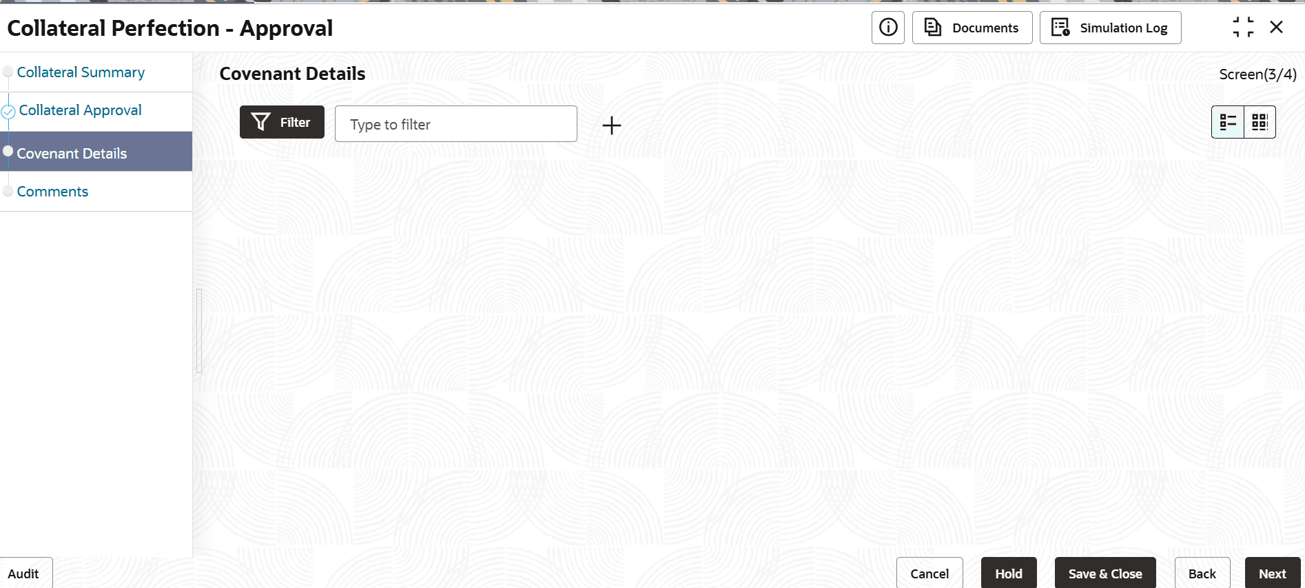

Figure 13-4 Collateral Approval_Covenant Details
- To add a covenant, click the add icon.The Covenant Details window is displayed.

The Covenant Details screen displays. - To link existing covenant, click the search icon and select the
Covenant Code.
The covenant codes maintained in the Covenant Maintenance screen are displayed in LOV.
Upon selecting the Covenant Code, Covenant name, Covenant description and Classification type are defaulted.
- To create new covenant, click the Click to add new
covenant link and specify all the details.
