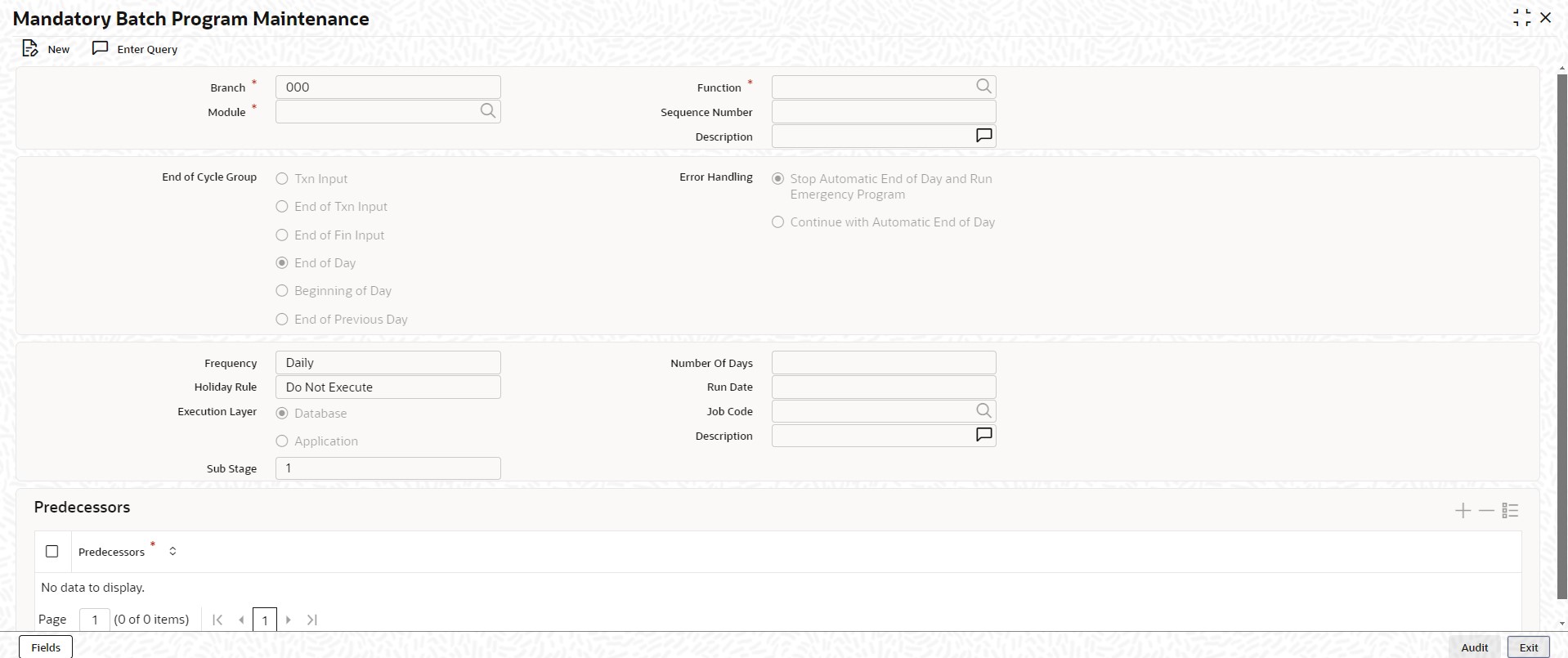

  1. On Homescreen, type EIDMANPE in the text box, and click Next.
    The Mandatory Batch Program Maintenance screen displays.
    Figure 1-2 Mandatory Batch Program Maintenance
  2. On the Mandatory Batch Program Maintenance screen, specify the fields.
    Table 1-2 Mandatory Batch Program Maintenance - Field Description
