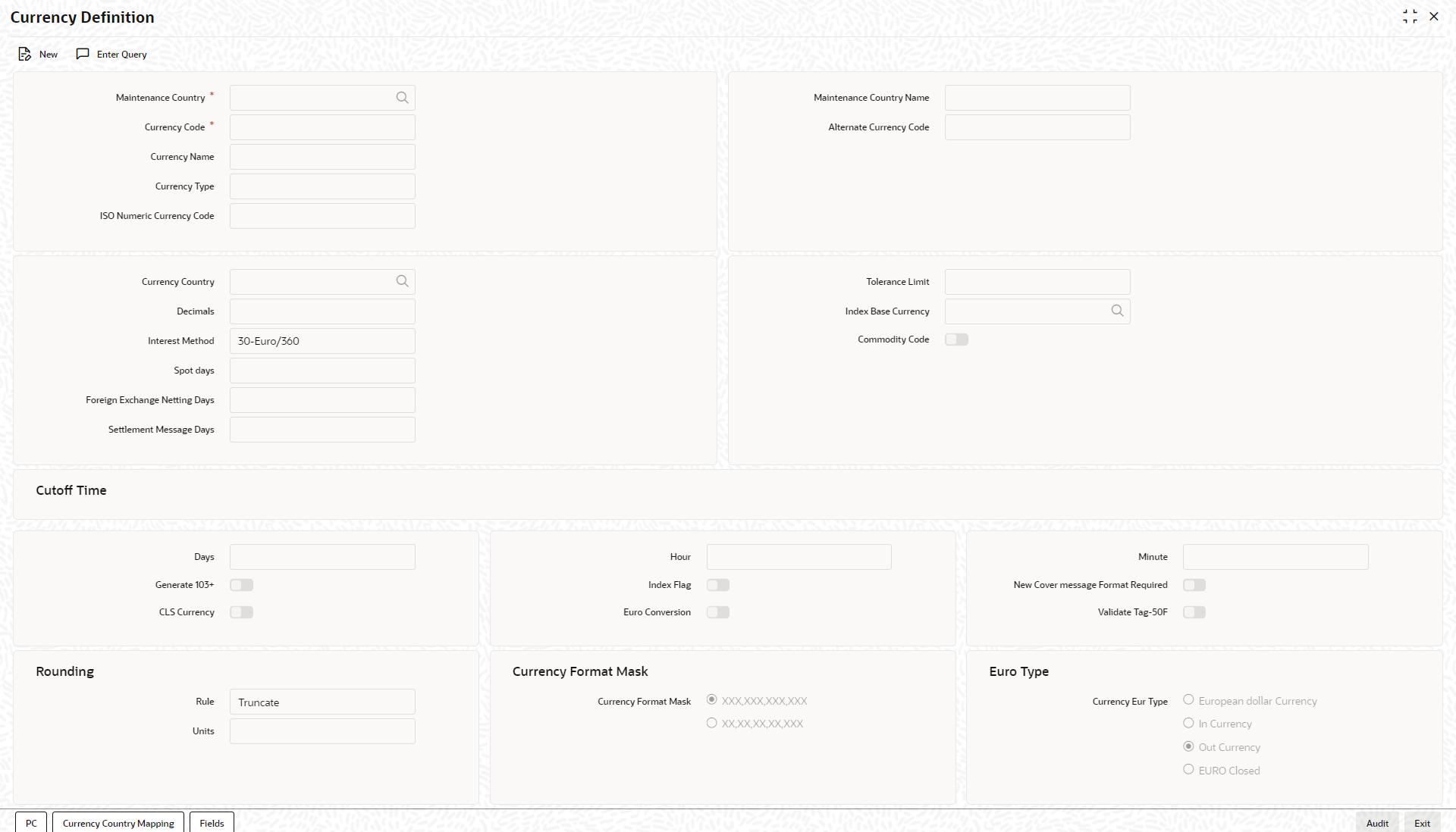

This topic explains systematic instructions to maintain currency definition.
In the Currency Definition screen, define the attributes of the currencies in which the bank can deal. For each currency, attributes like the SWIFT code for the currency, the country to which the currency belongs, the interest method, the spot days, the settlement days, etc. can be defined.
The currencies can be maintained only at the Head Office. The list of currencies will be made available to the branches based on the currencies that have been defined for the country linked to that branch.
The fields which are marked in asterisk are mandatory.- On Homescreen, type CYDCDEFE in the text box, and click Next.The Currency Definition screen displays.
- On the Currency Definition screen, specify the fields.For more information on fields, refer to the field description table.
Table 1-8 Currency Definition - Field Description
Field Description Maintenance Country Click Search and specify the country code for which the currency is maintained from the list of values. The list displays all the authorized and open country codes along with their description maintained in the system. For example, if the country code for a bank or a branch maintained which is operating in Singapore for the currency USD, then specify the country code as SG. The system defaults the field Maintenance Country as the US.
Maintenance Country Name The system displays the name of the country for which the currency is maintained. Currency Code Specify the code of the currency. The currencies are identified in Oracle FLEXCUBE Universal Banking by the SWIFT codes assigned to them. The currency will be identified by this code in all transactions that involve it. Currency Name Enter the detailed name of the currency in not more than thirty-five alphanumeric characters. Currency Type As per the bank’s requirement, the user can choose to classify currencies into different currency types. The bank can use its discretion to decide the basis of classifying currencies into different currency types. A currency type can consist of a maximum of three characters.
Depending on the customer account mask maintained, the value in the Currency Type field would be used during the generation of customer account numbers through the Customer Accounts Maintenance screen.
If it is decided to include currency type as part of the customer account number (in the account number mask), then at the time of creating a new customer account number, select the currency of the account number being generated. In the options list provided for currency, the currency code is displayed along with the associated currency type say, USD– 1, GBP – 2, etc. When the account number gets populated, it is the currency type that forms a part of the customer account number.
ISO Numeric Currency Code Specify the currency code specified by the International Standardization Organization. Alternate Currency Code Specify the alternate currency code. Country Currency Click Search and specify the country from the list of values. After identifying the currency, specify the country to which the currency belongs. Decimals Specify the number of decimal units up to which the currency can be denominated. The number of decimals allowed for any amount in the currency can be - - 0 - Currency with no decimals
- 2 - Currency with two decimals
- 3 - Currency with three decimals
- 4 - Currency with four decimals
Interest Method Select the interest rate to be used for transactions that involve this currency from the drop-down list. - 30(Euro)/360
- 30(US)/360
- Actual/360
