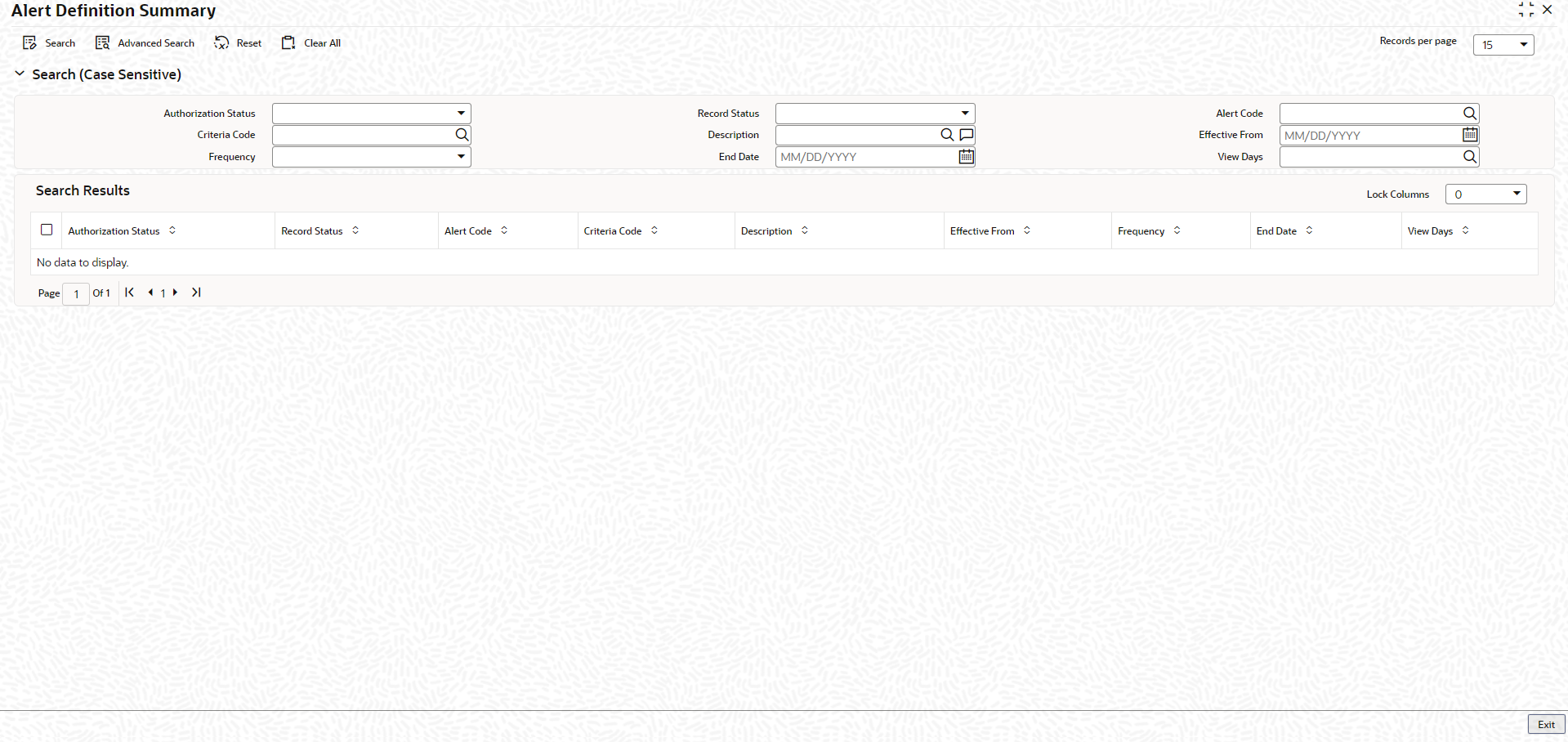

User can view a summary of the alerts defined in Oracle FLEXCUBE using Alert Definition Summary screen.
  1. On the Home screen, specify COSADMNT in the text box and click the Next icon.
    The Alert Definition Summary screen displays.
    Figure 2-67 Alert Definition Summary
    Table 2-92 Alert Definition Summary - Field Description
    Field Description
    Authorization Status Select the authorization status of the record. The available options are:
    • Authorized
    • Rejected
    • Unauthorized
    Record Status Select the record status of the record. The options are:
    • Open
    • Closed
    Alert code Click the Search icon and select the alert code from the list.
    Criteria Code Click the Search icon and select the criteria code from the list.
    Description Click the Search icon and select the description from the list.
    Effective From Select the effective date.
    Frequency Select the frequency from the drop-down list.
    End date Select the end date.
    View days Click the Search icon and select the view days from the list.
