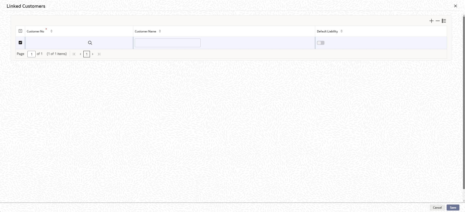

  1. On Liability Maintenance screen, click Linked Customers tab.
    The Linked Customers screen displays. For more information on fields, refer to the field description table.
    Table 2-27 Linked Customers - Field Description
    Field Description
    Customer No Click the Search icon and select the customer to be linked to liability from the available list.
    Customer Name This field will be defaulted from the customer selected.
    Default liability
    Switch to On to enable this parameter.
    Switch to off to disable this parameter.
    This will be checked for customers linked to liability through GEDCULIK.
  2. Click Save to save the record.
