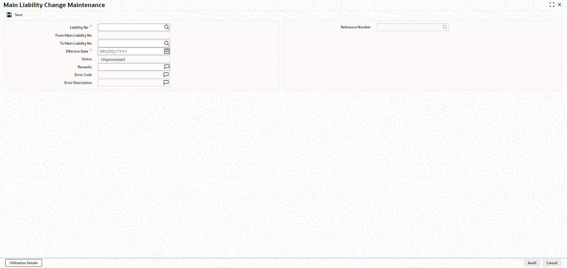

- On the Home screen, specify
GEDMLBCG in the text box and click the
icon.The Main Liability Change Maintenance screen displays.Figure 2-34 Main Liability Change Maintenance

Table 2-32 Main Liability Change Maintenance - Field Description
Field Description Liability No Click the
icon and select the child liability for which the
main liability has to be changed.
From Main Liability No The system displays the current main liability number, if the child liability is already linked to a main liability. To Main Liability No Click the
icon and select the main liability to which the
child liability has to be linked.
The system will not allow to capture the request, if the overall limit and the available balance of the new main liability and the liabilities up in the hierarchy are not sufficient to accommodate the child liability's overall limit.
Note: If the currency of child liability and new main liability is different, the system will consider the exchange rate configured in GEDPARAM for overall limit validation.
If the To Main Liability No is not selected, then the child liability's existing link to the main liability, if any, will be removed and no main liability will be attached to the child liability.
Effective Date Specify the date on which the parent liability change request is to be processed. The effective date can be present date or future date. Note: If the effective date falls on holiday, the main liability change will happen based on the holiday configuration in GEDPARAM.
