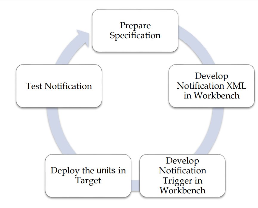

4 Notification Development
This topic provides an overview of the Notification Development process.
Prerequisite for Notification development and testing
Following are the prerequisite for notification development:
  • Target FLEXCUBE Environment with Notification framework installed.
  • Development Workbench link mapped to the FLEXCUBE environment.
  • Required Query Web services developed and tested.
Figure 4-1 Architecture- Notification Development

Notification Process
There will be one trigger for the base table of notification and in case of multiple notifications sharing the same base table, there will be no new triggers created. Instead, the same trigger created on the base table will be reused. This approach reduces the number of triggers being used for notifications.
Development process in Development Workbench
The notification development process in Workbench is split into two steps:
  1. Notification Triggers
  2. Notification Filter Procedure
The first step is to create notification triggers for base tables. The trigger generated from Workbench will be inserting key details into a static notification log table. The following details will be captured:
  • Trigger code: A unique value for a notification trigger.
  • Base Table: The base table on which, the trigger is built.
  • When Clause: A simple when clause for the notification trigger.
The second step is to capture the details of notifications and generate the notification filter procedure. The following details are captured:
  • Notification code: A unique value to identify a notification.
  • Description: Meaningful description of the notification.
  • Gateway Service
