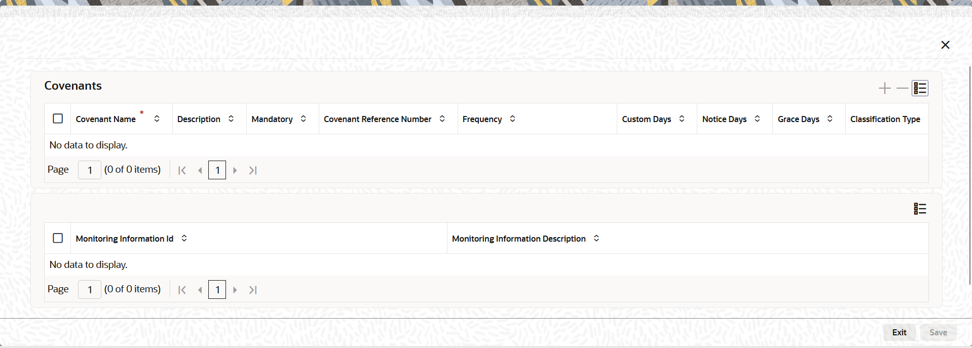

2.2.1 Covenants
This topic provides information on Maintaining Covenant Details for Collateral Category.
The fields, which are marked with an asterisk, are mandatory.- On Collateral Categories screen, click the
Covenants tab.The Covenants screen is displayed.
- On Covenants screen, specify the fields.
The Revision Date for the covenant is generated based on the Frequency and Due date.
For example, if the collateral category covenant for a particular covenant name the frequency is monthly and the due date is 15. Based on the date of creation of the collateral covenant category (say 20 JAN 2008) the revision date is 15-Feb-2008.
For more information on fields, refer to the field description table.Table 2-7 Covenants - Field Description
