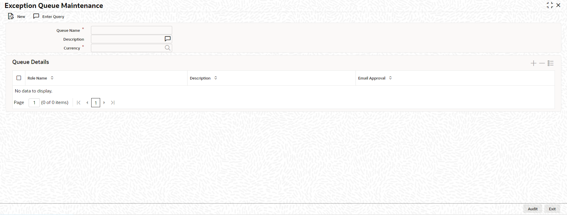

The Exception Queue Maintenance screen allows you to maintain exception queue records with their respective user roles allowed for authorization.
  1. On the Home screen, specify GEDQUEMN in the text box and click the Next icon.
    The Exception Queue Maintenance screen is displayed.
    Figure 2-38 Exception Queue Maintenance
  2. On Exception Queue Maintenance screen, click New and specify the fields.
