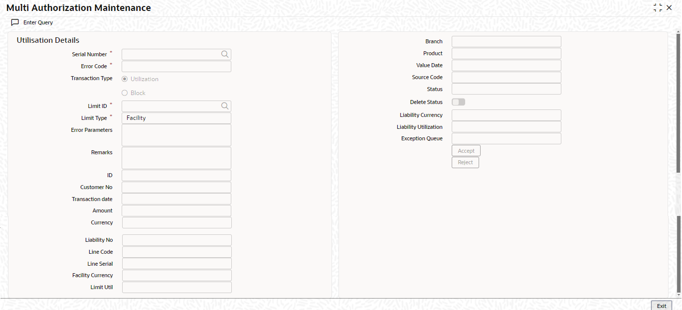

Whenever Utilization Transactions has been breached, then the utilization transaction would require multiple authorizations. The Authorizer must either Accept or Reject the breached transaction using the Multi Authorization Maintenance screen GEDDAUTH. Using this screen, you can get a list of transactions which requires authorization.
The fields, which are marked with an asterisk, are mandatory.- On the Home screen, specify
GEDDAUTH in the text box and click the
icon.The Multi Authorization Maintenance screen is displayed.Figure 2-40 Multi Authorization Maintenance
- On Multi Authorization Maintenance screen, specify the
fields.For more information on fields, refer to the field description table.
All the fields available in the Multi Authorization Maintenance screen are display only fields. Only Accept or Reject for authorization of the breached transaction is allowed.Table 2-127 Multi Authorization Maintenance - Field Description
Field Description Serial Number Click the
icon and select the serial number from the list.
This is the Oracle Banking Enterprise Limits and Collateral
Management generated unique identifier for the transaction, which
specifies the exception queue in which transaction has been
parked.
Error Code Specifies the error code of the transaction. Transaction Type Select the transaction type as Utilization or Block. Limit ID Click the
icon and select thhe limit ID from the list. The
authorizer can select the appropriate dual authorization
transaction by selecting the list of values against the
Serial Number along with
Limit ID.
Limit Type Select the limit type as Facility, Liability, Collateral, or Collateral Pool. Error Parameters Specifies the error parameters associated to the transaction. Remarks Capture your remarks for the transaction. ID Specifies the Oracle Banking Enterprise Limits and Collateral Management utilization ID. Customer No Specifies the customer number of the utilization transaction. Customer number entered should be valid customer number in Oracle Banking Enterprise Limits and Collateral Management system. Transaction date Indicates the date and time when the transaction was entered in the external system. Amount Indicates the utilization amount. Currency Indicates the currency of the utilization transaction. Currency code entered should be a valid currency code in Oracle Banking Enterprise Limits and Collateral Management system. Liability No Specifies the liability number of the utilization transaction. Liability number entered should be valid liability number in Oracle Banking Enterprise Limits and Collateral Management system. Line Code Specifies the facility code of the utilization transaction. Facility code entered should be valid facility code in Oracle Banking Enterprise Limits and Collateral Management system. Facility Currency Specifies the facility currency. Limit Util Indicates the limit utilization amount. Branch Indicates the transaction branch. Product Indicates external product code of the utilization transaction. This is only applicable if the utilization has been done from an external product Value Date Specifies the value date of the transaction. If value is not passed then system defaults to Oracle Banking Enterprise Limits and Collateral Management present branch date. Source Code Indicates the product processor name from where the transaction has been originated. This field is as part of Header section (Source Code). This is applicable only if the utilization has been done from an external product. Status Indicates the utilization status. The available options are: - Active
- Reverse
- Liquidated
Delete Status Switch to
to delete to transaction.
Switch to
to keep the record.
Liability Currency Specifies the liability currency. Liability Utilization Indicates the liability utilization amount. Exception Queue Accept Reject - Click Save to save the record.
