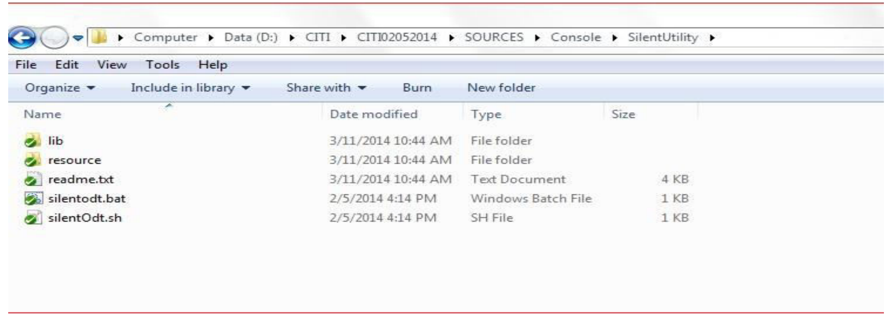

After copying the installer sources and library folder to the local system, make sure to uncheck the read-only check box in source properties and apply the same to all the subfolders.
The figure below shows the source folder in the local system:
Figure 6-1 Source Folder of SilentODTUtility

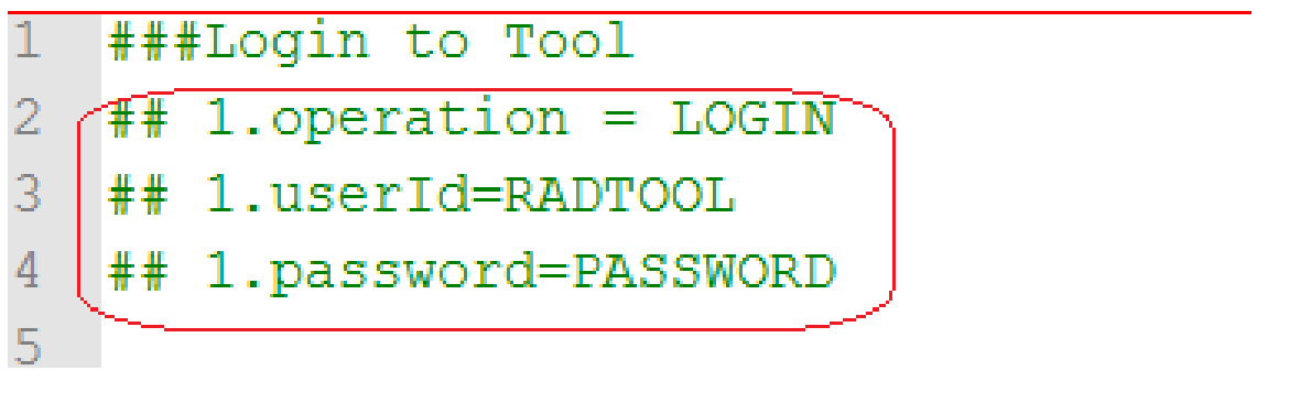

    1. LOGIN
      Login should always be the first operation to be configured as part of any execution.
      Table 6-2 Login to Tool
      Field Description
      Operation LOGIN
      User Id ODT User Id which is created in the ODT Application.
      Password ODT Password which is created in the ODT Application (should be encrypted using Utility).

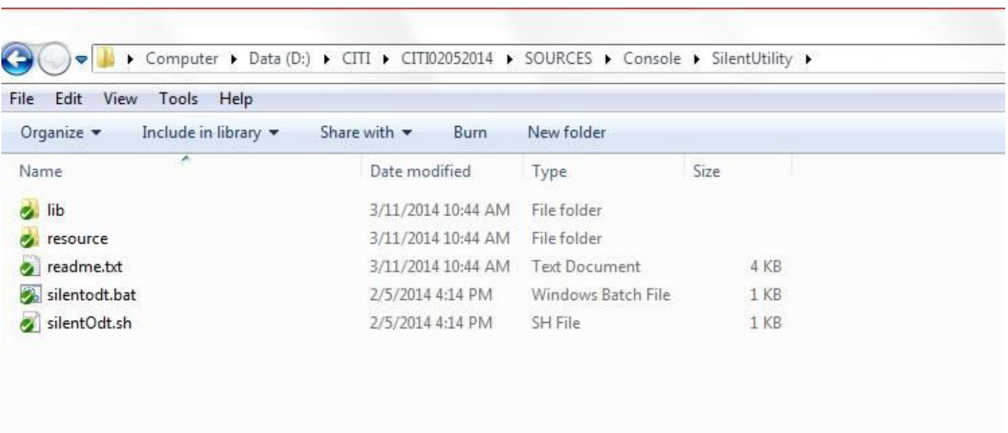

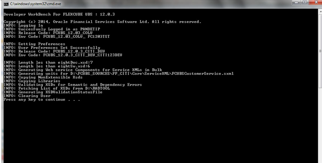

Provide the following values for gen parameter of REST_GENERATION. To generate Rest service Artifacts, the user has to double click on the batch file silentOdt.bat/sh present in the ODT source.
Figure 6-4 SilentODT Sources Folder
Figure 6-5 SilentODT Command Prompt
After the successful built operation, The Rest artifacts files will be generated in the destination directory specified.
