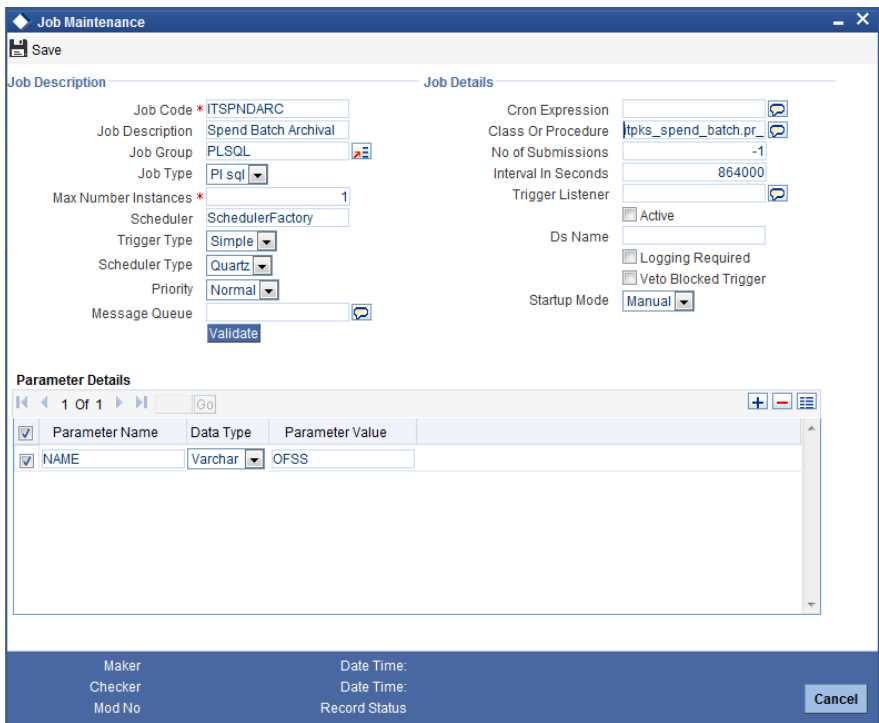

- Job params can be added to a particular PLSQL job in this screen as shown above, which are passed to the procedure maintained.
For example,Suppose we have created a new ITSPNDARC PLSQL job for Spend Batch Archival. Here it is a PLSQL job, where the procedure to be executed is itpks_spend_batch.pr_spend_archival.
