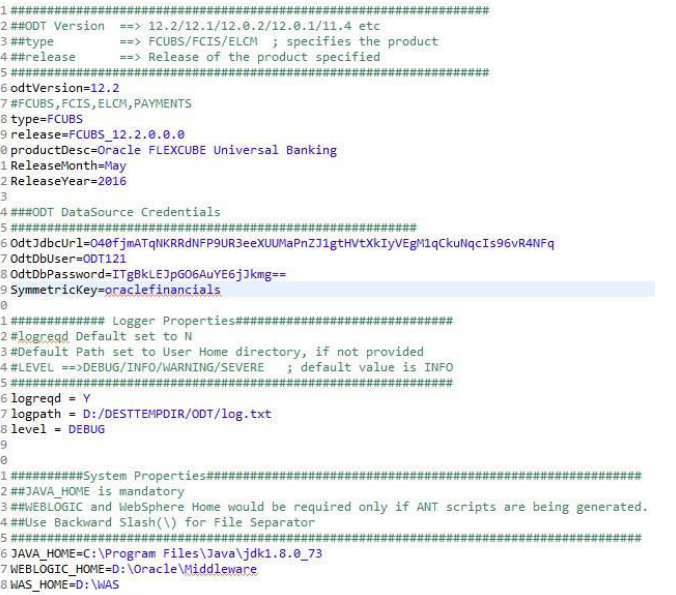

SilentOdt.properties
The sample property file has been given below. Refer to the details mentioned for each property in the below table. Some of them are encrypted using ODTPassEncryption.bat (ODTPassEncryption.sh for UNIX). Use 16 characters length of the symmetric key for encryption (Preferably Alphanumeric) which will be prompted for input from the user when the encryption utility is launched. The same symmetric key must be mentioned in the property file as well.
Figure 6-1 File attachment- SilentOdt.properties
Table 6-1 Open Development Tool Data Source Detail Credentials
Open Development Tool Data Source Detail Credentials Description
OdtJdbcUrl Encrypted JDBC URL, Sample JDBC URL (before encrypting) jdbc:oracle:thin:@10.184.xx.xx:1521:FCDEMO
OdtDbUser DB User Name
OdtDbPassword Encrypted Password.
SymmetricKey The key is used when encrypting the JDBC URL and password. This should have exactly 16 characters.
User must use the same key for both JDBC URL and password encryption.
Table 6-2 Logger Properties
Logger Properties Description
Logreqd Y/N. Default set to N.
Logpath Provide the path where the Logger files will be generated.
Level Provide the Logger Level. This can be either SEVERE/WARNING/INFO/CONFIG/FINE/FINER/FINEST. Provide as FINEST for writing detailed log. The default value would be set to INFO.
Table 6-3 System Properties
System Properties Description
JAVA_HOME Maintain the Java(JDK) installed location.
WEBLOGIC_HOME Maintain the Oracle WebLogic installed location.
WAS_HOME Maintain the IBM Websphere installed location.

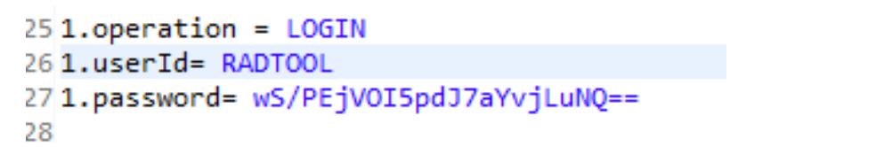

  1. LOGIN
    LOGIN should always be the first operation to be configured as part of any execution.
    Table 6-4 Login to Tool
    Field Description
    Operation LOGIN
    User Id Open Development Tool User Id which is created in the Open Development Tool Application.
    Password Open Development Tool Password which is created in the Open Development Tool Application. Encrypted using ODTPassEncryption.bat.

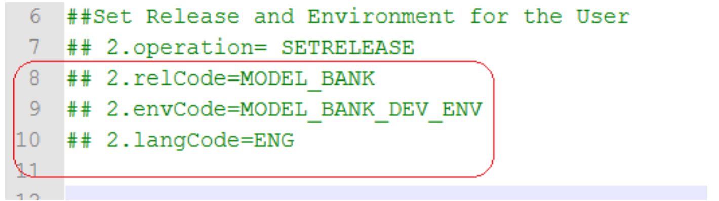

  2. SETRELEASE
    This operation can be used for setting Release and Environment Preferences for SilentODTUtility. Connection to the Oracle FLEXCUBE Universal Banking schema would be established based on data maintained in Open Development Tool or through the data in env_config.xml as explained in an earlier section.
    Figure 6-3 SETRELEASE Operation
    Table 6-5 Release and Environment Details for User
    Field Description
    Operation SETRELEASE
    relCode Open Development Tool Release Code which is created in the Open Development Tool Application.
    envCode Open Development Tool Environment Code which is created in the Open Development Tool Application.
    langCode Lang code for the above-mentioned release code.

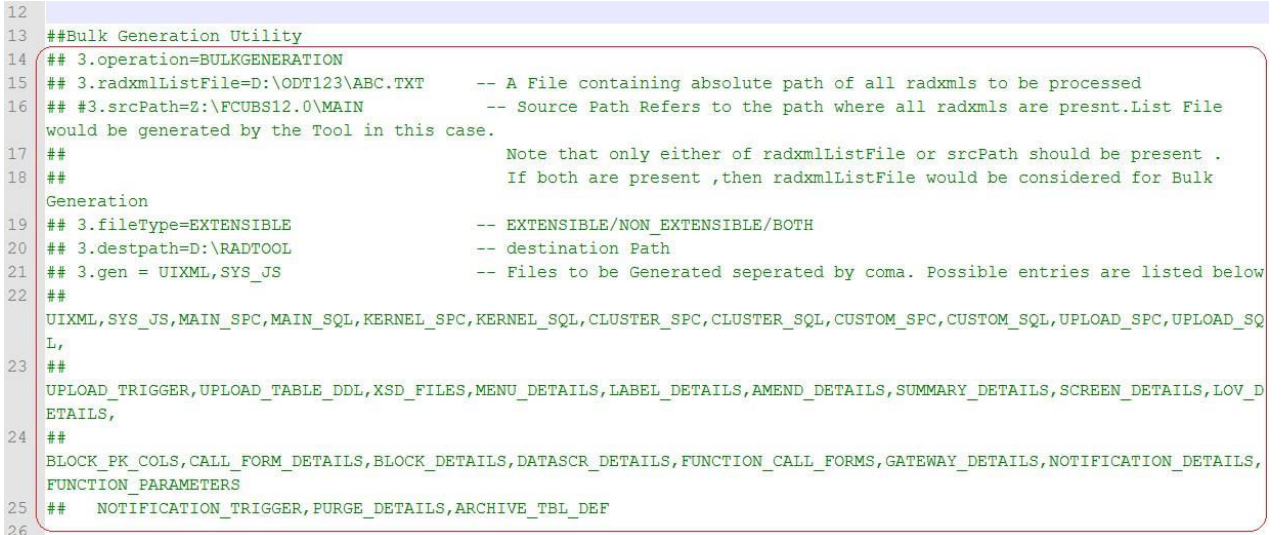

  3. BULKGENERATION
    For generating all RADXML artifacts for release in bulk this feature can be used.
    Table 6-6 BULKGENERATION
    Field Description
    radxmlListFile Prepare text file which contains absolute path of all RADXML's. Provide the same file path.
    srcPath Source path refers to the path where all RADXML's are presented. List File would be generated by the tool in this case. Note that only either radxmlListFile or srcPath should be present. If both are present, then the radxmlListFile parameter would be considered for Bulk Generation.
    fileType
    • EXTENSIBLE: artifacts generated only for extensible screens.
    • NON_EXTENSIBLE: artifacts generated only for non-extensible screens.
    • BOTH: artifacts for all files would be generated.
    destpath Provide the path where the files will be generated.
    gen Provide the type of files to be generated. For example, UIXML, SYS_JS, MAIN_SPC, MAIN_SQL,KERNEL_SPC, KERNEL_SQL
    Figure 6-4 SilentODT Bulk Generation Properties
    Table 6-7 Bulk Generation Utility
    Input Output
    radxmlListFile UIXML,SYS_JS,MAIN_SPC,MAIN_SQL,KERNEL_SPC,KERNEL_SQL, CLUSTER_SPC,CLUSTER_SQL,CUSTOM_SPC,CUSTOM_SQL, UPLOAD_SPC,UPLOAD_SQL,UPLOAD_TRIGGER,UPLOAD_TABLE_DDL, XSD_FILES,MENU_DETAILS,LABEL_DETAILS,AMEND_DETAILS, SUMMARY_DETAILS,SCREEN_DETAILS,LOV_DETAILS, BLOCK_PK_COLS,CALL_FORM_DETAILS,BLOCK_DETAILS, DATASCR_DETAILS,FUNCTION_CALL_FORMS,GATEWAY_DETAILS, NOTIFICATION_DETAILS,FUNCTION_PARAMETERS NOTIFICATION_TRIGGER,PURGE_DETAILS,ARCHIVE_TBL_DEF in destpath.
    srcPath
    fileType
    gen
    destpath

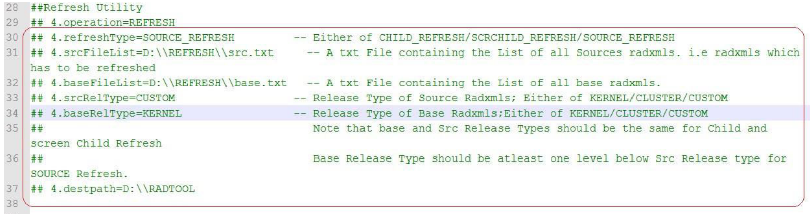

  4. REFRESH
    Refresh Functionality allows developers to upgrade the existing RADXML to its later version keeping the sub-version-specific changes intact. Three kinds of refresh can be done using the Tool. (Refer to the Development Workbench - Source Upgrade)
    1. Child Refresh
    2. Screen Child Refresh
    3. Source Refresh
    Table 6-8 REFRESH
    Field Description
    Refresh Type Provide the refresh type (CHILD_REFRESH/SCRCHILD_REFRESH/SOURCE_REFRESH).
    srcFileList A text file containing the list of all source RADXMLs. i.e. RADXMLs have to be refreshed.
    baseFileList A text file containing the list of all base RADXMLs.
    srcRelType Provide the release type of source RADXMLs list(KERNEL/CLUSTER/CUSTOM).
    baseRelType Provide the release type of base RADXMLs list (KERNEL/CLUSTER/CUSTOM).
    Figure 6-5 SilentODT Refresh Properties
    Table 6-9 Refresh Utility
    Input Output
    refreshType Refreshed Radxml’s in destpath.
    srcFileList Refreshed Radxml’s in destpath.
    baseFileList Refreshed Radxml’s in destpath.
    srcRelType Refreshed Radxml’s in destpath.
    baseRelType Refreshed Radxml’s in destpath.
    destpath Refreshed Radxml’s in destpath.

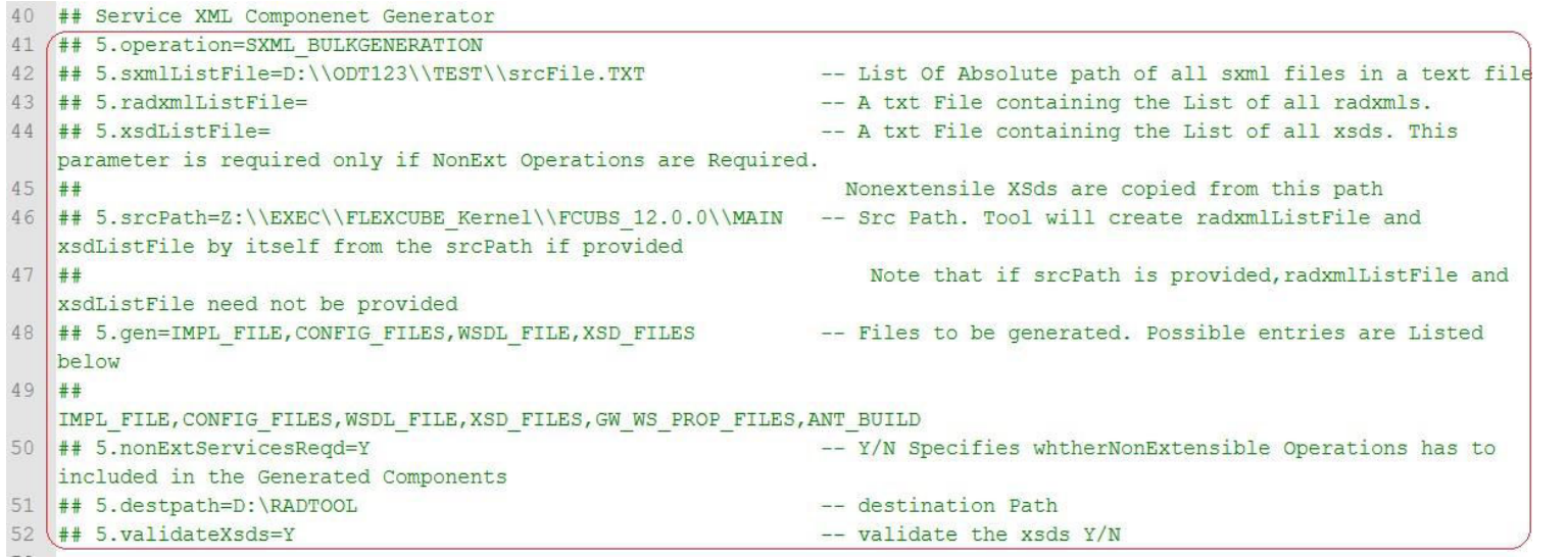

  5. Service XML Bulk Generation
    Web service artifacts can be generated through this operation.
    Table 6-10 Service XML Bulk Generation
    Field Description
    sxmlListFile Prepare text file which contains absolute path of all Service XML.
    radxmlListFile Prepare a text file that contains the absolute path of all RADXML which are used for those services.
    xsdListFile Prepare a text file that contains the absolute path of all XSDs which are used for those services. Non-extensibility/Common XSDs are copied from this path.
    srcPath Provide source folder path which is an option (tool will create radxmlListFile and xsdListFile by itself from the srcPath). Note that if srcPath is provided, radxmlListFile and xsdListFile need not be provided.
    gen Provide type of files to be generated (separated by comma). Options are IMPL_FILE, CONFIG_FILES,WSDL_FILE,XSD_FILES,GW_WS_PROP_FILES,ANT_BUILD.
    nonExtServicesReqd Y/N, Specifies whether NonExtensible Operations has to include in the generated components.
    validateXsds Y/N, Default set to Y. If the value is set to Y all XSD will be validated by the tool.
    Figure 6-6 SilentODT Service XML Bulk Generation Properties
    Table 6-11 Service XML Component Generator
    Input Output
    sxmlListFile IMPL_FILE,CONFIG_FILES,WSDL_FILE,XSD_FILES,GW_WS_PROP_FILES,ANT_BUILD in destpath
    radxmlListFile
    xsdListFile
    srcPath
    nonExtServicesReqd
    destpath
    validateXsds

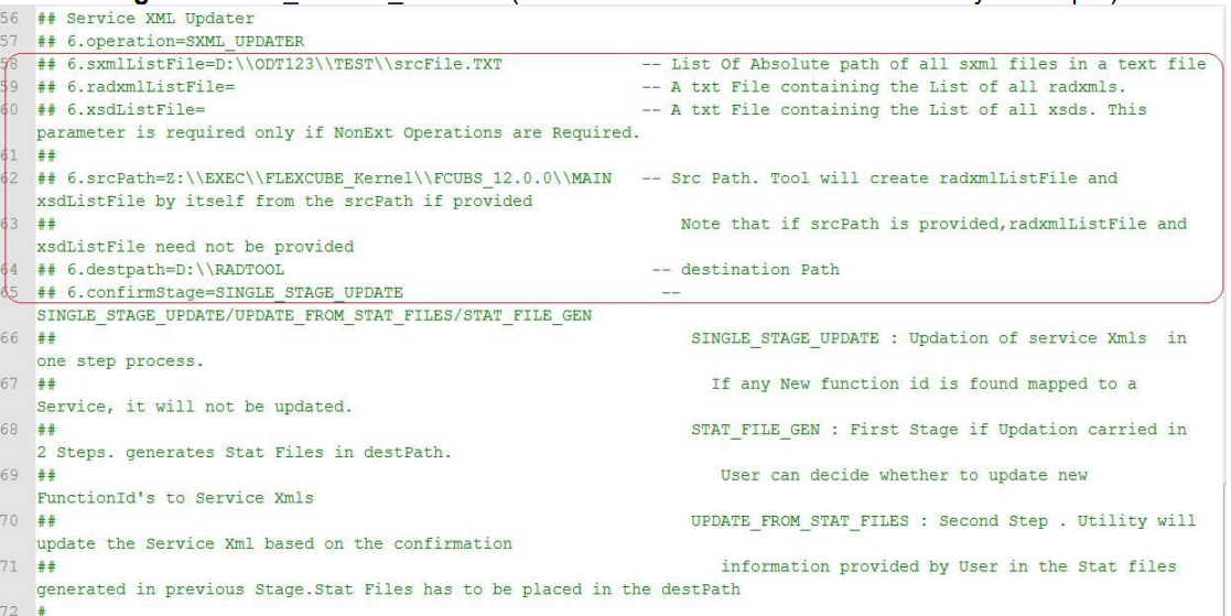

  6. Service XML Updater
    This feature can be used to update the Service XMLs with the latest data from RADXMLs. The following details will be updated:
    1. Any addition, deletion, or modification of operation codes in function Id would be updated in Service XML.
    2. If any function Id is removed from the service (specified in RADXML); then the same would be removed from Service XML. Note that if any new function Id is attached to the service (in RADXML); then the same will not be updated in the Service XML. This has to add manually in the Service XML through the Open Development Tool user interface.
    Table 6-12 Service XML Updater
    Field Description
    Operation SXML_UPDATE
    sxmlListFile Prepare a text file that contains the absolute path of all Service XML. Provide the same file path.
    radxmlListFile Prepare a text file that contains the absolute path of all RADXMLs which are used for those services. Provide the same file path.
    srcPath Provide source folder path. This field is optional (tool will create radxmlListFile and sxmlListFile by itself from the srcPath). Note that if srcPath is provided, radxmlListFile and sxmlListFile need not be provided.
    confirmStage SINGLE_STAGE_UPDATE (Default Value should not be modified by the developer)
    Figure 6-7 SilentODT Service XML Updater Properties
    Table 6-13 Service XML Updater
    Input Output
    xsdListFile Updated Service XML’s in destpath.
    sxmlListFile Updated Service XML’s in destpath.
    radxmlListFile Updated Service XML’s in destpath.
    srcPath Updated Service XML’s in destpath.
    destpath Updated Service XML’s in destpath.
    confirmStage Updated Service XML’s in destpath.

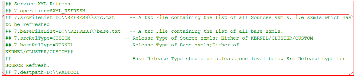

  7. Service XML Refresh
    Refresh Functionality allows us to upgrade the existing service XML to its later version keeping the sub-version-specific changes intact.
    Table 6-14 Service XML Refresh
    Field Description
    srcFileList Prepare a text file that contains the absolute path of all Service XML, the same file should be provided i.e. service XML which has to be refreshed.
    baseFileList Prepare a text file that contains the absolute path of all base service XMLs. Provide the same file path. For instance, for a custom development team; all the latest Kernel files have to be mentioned in baseFileList while the custom Service XMLs to be refreshed has to be mentioned in the srcFileList.
    srcRelType Provide the release type of Source RADXMLs list (KERNEL/CLUSTER/CUSTOM).
    baseRelType Provide the release type of base RADXMLs list (KERNEL/CLUSTER/CUSTOM). baseRelType should be at least one level below srcRelType for SOURCE Refresh. For Instance, for a custom development team, srcRelType would be CUSTOM and baseRelType can be either KERNEL/CLUSTER depending on the base source type.
    Figure 6-8 SilentODT Service XML Refresh Properties
    Table 6-15 Service XML Refresh
    Input Output
    operation Refreshed Service XML’s in destpath.
    srcFileList Refreshed Service XML’s in destpath.
    baseFileList Refreshed Service XML’s in destpath.
    srcRelType Refreshed Service XML’s in destpath.
    baseRelType Refreshed Service XML’s in destpath.
    destpath Refreshed Service XML’s in destpath.

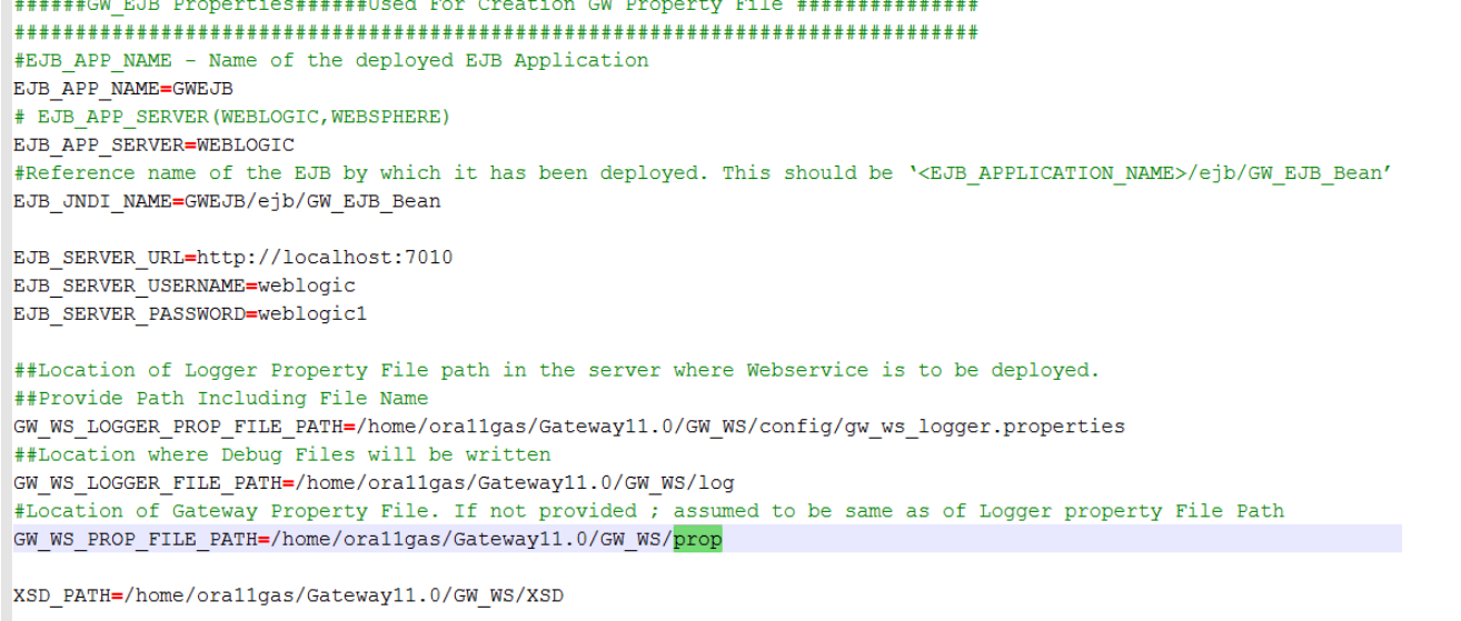

GW_CONFIG.properties
These properties file parameters are used for the generation gateway web service properties files. This configuration file is optional. Provide only if Gateway Web service property files (GW_WS_PROP_FILES) is being generated as part of Service XML Bulk generation operation.
Table 6-16 GW_CONFIG.properties
Field Description
EJB_APP_NAME Provide the Name of the deployed EJB Application.
EJB_APP_SERVER Provide Application server name in which ear deployed.
EJB_JNDI_NAME EJB JNDI Name is the reference name of the EJB by which the EJB has been deployed.
EJB_SERVER_URL Application server IP Address & port where the EJB application is deployed.
EJB_SERVER_USERNAME User Name of the application server where the EJB application is deployed.
EJB_SERVER_PASSWORD Password of the application server where the EJB application is deployed.
GW_WS_LOGGER_PROP_FILE_PATH Provide the Location of Logger Property File path in the server where web service is to be deployed. Provide path including the file name. For example,
  • Windows path: D:/Kernel11.1/GW_WS/config/gw_ws_logger.properties
  • Linux or UNIX: /oraint1/kernel//Gateway/GWWS/config/gw_ws_logger.properties
GW_WS_LOGGER_FILE_PATH Provide the location where debug files will be written. For example,
  • Windows: D:/Kernel11.1/GW_WS/log/
  • Linux or Unix: /oraint1/kernel/FC120INS_DEBUG/Gateway/GWWS/log
GW_WS_PROP_FILE_PATH Path where property file is placed in the server. This will be referred to in web.xml of the web service property file. For example,
  • Windows: D:/Kernel11.1/GW_WS/prop/
  • Linux or UNIX: /oraint1/kernel/FC120INS_DEBUG/Gateway/GWWS/prop
XSD_PATH XSD Path
Figure 6-9 SilentODT GW Config Properties
