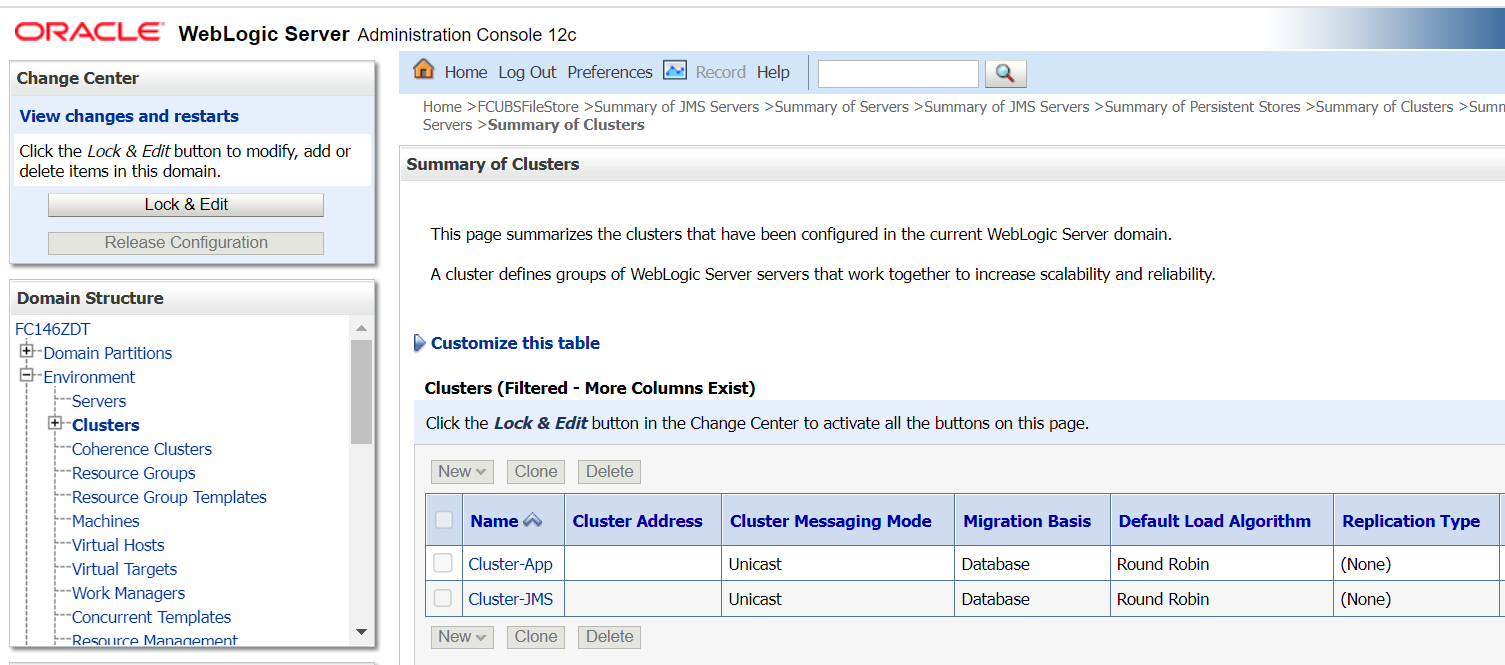

  1. Under the Domain Structure left panel, click the Environment drop-down option, and then click Clusters.
    The Summary of Clusters screen displays.
    Figure 4-11 Summary of Clusters
  2. Select Cluster-JMS from clusters table.

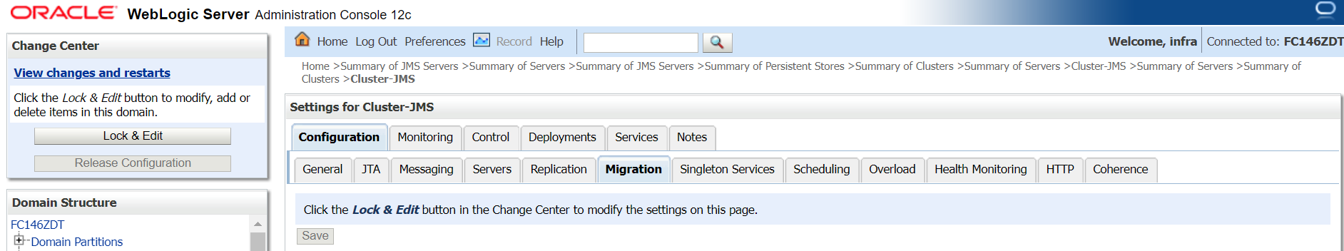

    The Settings for Cluster-JMS screen displays.
    Figure 4-12 Settings for Cluster-JMS
  3. Click the Migration Tab.
  4. Change Migration Basis to Consensus, and then click Save.
