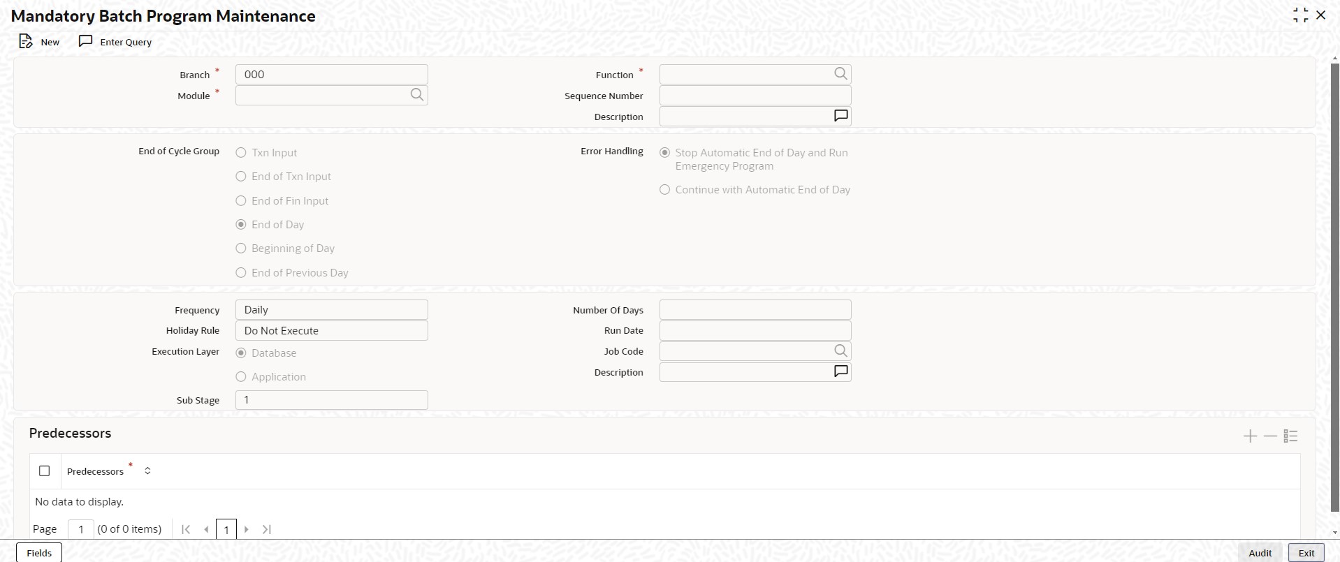

The fields which are marked in asterisk are mandatory.- On Homescreen, type EIDMANPE in the text box, and click Next.The Mandatory Batch Program Maintenance screen displays.
Figure 1-2 Mandatory Batch Program Maintenance
- On the Mandatory Batch Program Maintenance screen, specify the fields.For more information on fields, refer to the field description table.
Table 1-2 Mandatory Batch Program Maintenance - Field Description
