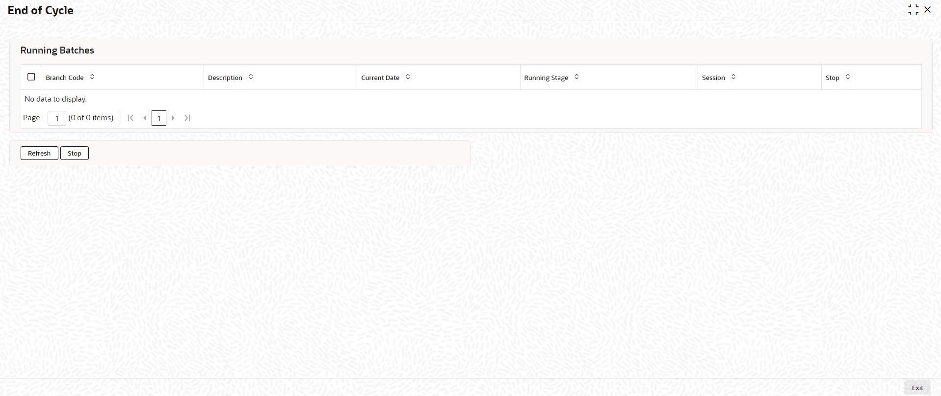

  1. On Homescreen, type AEDSTOP in the text box, and click Next.
    The End of Cycle screen displays. The system displays the running branches on this screen.
  2. To stop the process for the selected branches, check the box under Stop against the branch which wish to be stopped, and click Stop at bottom.
  3. Click Exit to end the transaction.
