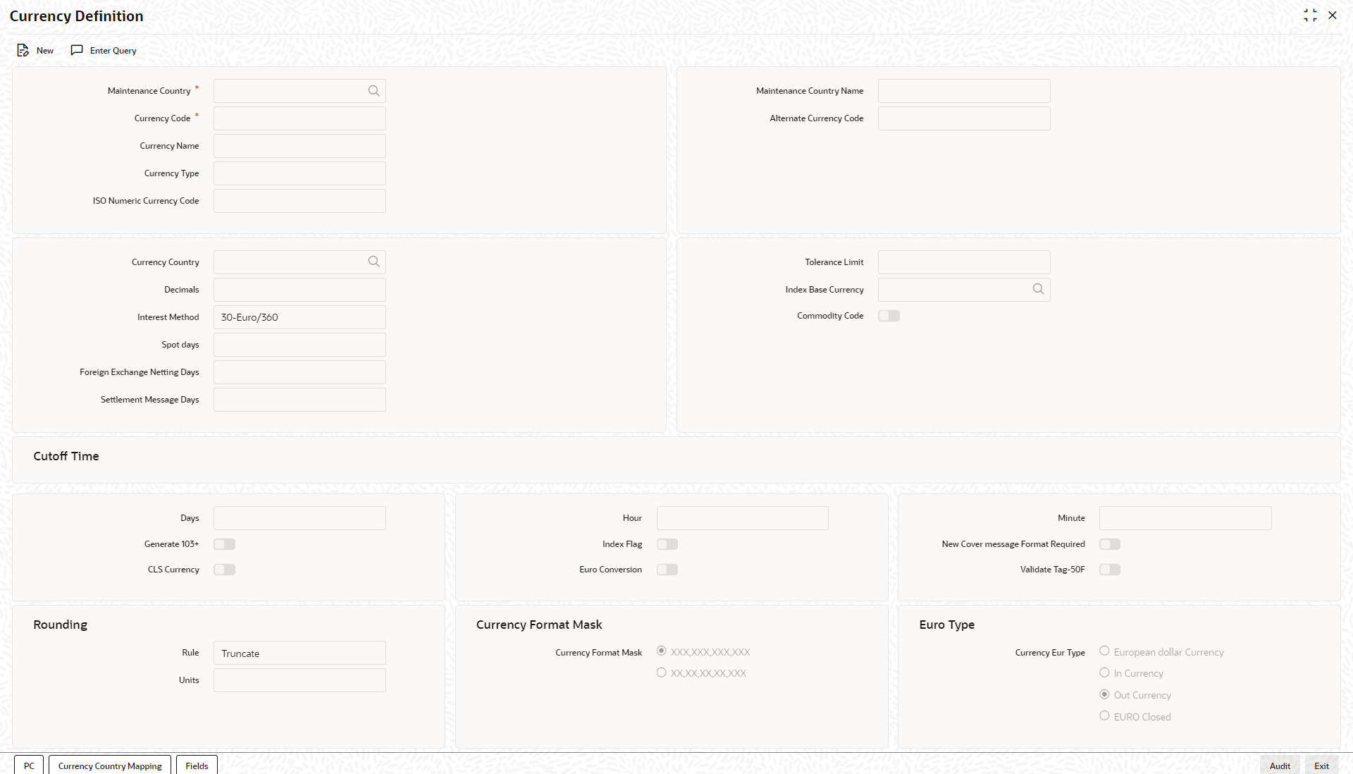

  1. On Homescreen, type CYDCDEFE in the text box, and click Next.
    The Currency Definition screen displays.
  2. On the Currency Definition screen, specify the fields.
    Table 1-8 Currency Definition - Field Description
    Field Description
    Maintenance Country Click Search and specify the country code for which the currency is maintained from the list of values. The list displays all the authorized and open country codes along with their description maintained in the system.

    • February - 30 days (In 30 Euro Method, February always has 30 days, leap year or not)
    • March - 24 days (include from date exclude to date)
    Total = 113 days
    When the interest period crosses from a non-leap year to a leap year (or otherwise), the basis of actual days has to be treated separately in each year.
    30(US)/Actual 10,000x10/100 x (30/365+84/366)
    In this method, the number of days is calculated as follows -
    • December - 30 days (include from date exclude to date)
    • January - 30 days (In 30 US Method, all months have 30 days, only for February are the actual number of days calculated.)
    • February - 29 days (In 30 US Method, actual days are accounted for the leap year.)
    Total = 113 days
    Actual/Actual 10,000x10/100 x (31/365 + 84/366)
    • December - 31 days (include from date exclude to date)
    • January - 31 days
    • February - 29 days (leap year)
    Total = 31 + (31+29+24=84) =115
    Therefore, the denominator for the 31 days in December is 365 as it is a non-leap year and the denominator for the 84 days in 2000 is 366 as it is a leap year.
  3. Click Exit to end the transaction.
