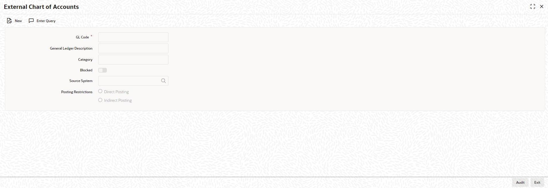

  1. On Homescreen, type STDCRGLM in the text box, and click Next.
    The External Chart of Accounts screen displays.
    Figure 1-22 External Chart of Accounts
  2. On the External Chart of Accounts screen, specify the fields.
    Table 1-31 External Chart of Accounts - Field Description
    Field Description
    GL Code Specify a code for the general ledger.
    General Ledger Description Specify a description for the general ledger code.
    GL Category Select the category of the general ledger from the drop-down list.
    • Asset
    • Liability
    • Income
    • Expense
    • Contingent Asset
    • Contingent Liability
    • Memo
    • Position
    • Position Equivalent
    Blocked Check this box to block the GL for accounting entries.
    Source System Click Search and specify the source system from the list of values.
    Posting Restrictions Select one of the following options to indicate the General Ledger code's posting:
    • Direct Posting
    • Indirect Posting
  3. Click Exit to end the transaction.
