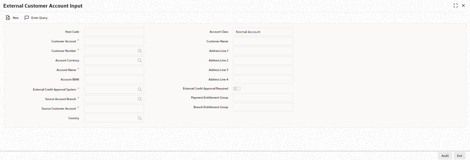

  1. On Homescreen, type STDCRACC in the text box, and click Next.
    The External Customer Account Input screen displays.
    Figure 1-28 External Customer Account Input
  2. On the External Customer Account Input screen, specify the fields.
    Table 1-37 External Customer Account Input - Field Description
    Field Description
    Host Code Specify the Host Code that is linked to the logged-in user of the branch.
    Customer Account Specify the customer account number.
    Customer Number Specify the required customer number. The list displays all valid customer numbers maintained in the system.
    Account Currency Specify the required currency of the external customer. The list displays all valid currencies maintained in the system.
    Account IBAN Specify the IBAN that is linked to the customer.
    Account Name Specify the name of the account holder.
    External Credit Approval System Specify the External Credit Approval System for which accounts are mapped. The list displays all valid ECA systems maintained in the system.
    Source Account Branch Specify the Source Account Branch.
    Source Customer Account Specify the Source Customer Account.
    Country Specify the Country.
    Account Class Select the required account class of the external customer account.
    • Normal Account
    • Nostro Account
    • Multi Currency Account
    The account currency should be null if the account class is selected as a multi-currency account. The system throws an error message if the account class is selected as a multi-currency account and the account currency is specified.
    Customer Name Specify the name of the customer.
    Address Line 1 Specify the first line of the customer’s address.
    Address Line 2 Specify the second line of the customer’s address.
    Address Line 3 Specify the third line of the customer’s address.
    Address Line 4 Specify the fourth line of the customer’s address.
    External Credit Approval Required Check this box to indicate that an ECA check is required for the external customer account.
    Payment Entitlement Group Specify the payment entitlement group. The adjoining list displays all valid payment entitlement groups maintained in the STDCRAEG (Entitlement Group Maintenance) screen.
    Branch Entitlement Group Specify the branch entitlement group. The adjoining list displays all valid branch entitlement groups maintained in the STDCRAEG (Entitlement Group Maintenance) screen.
