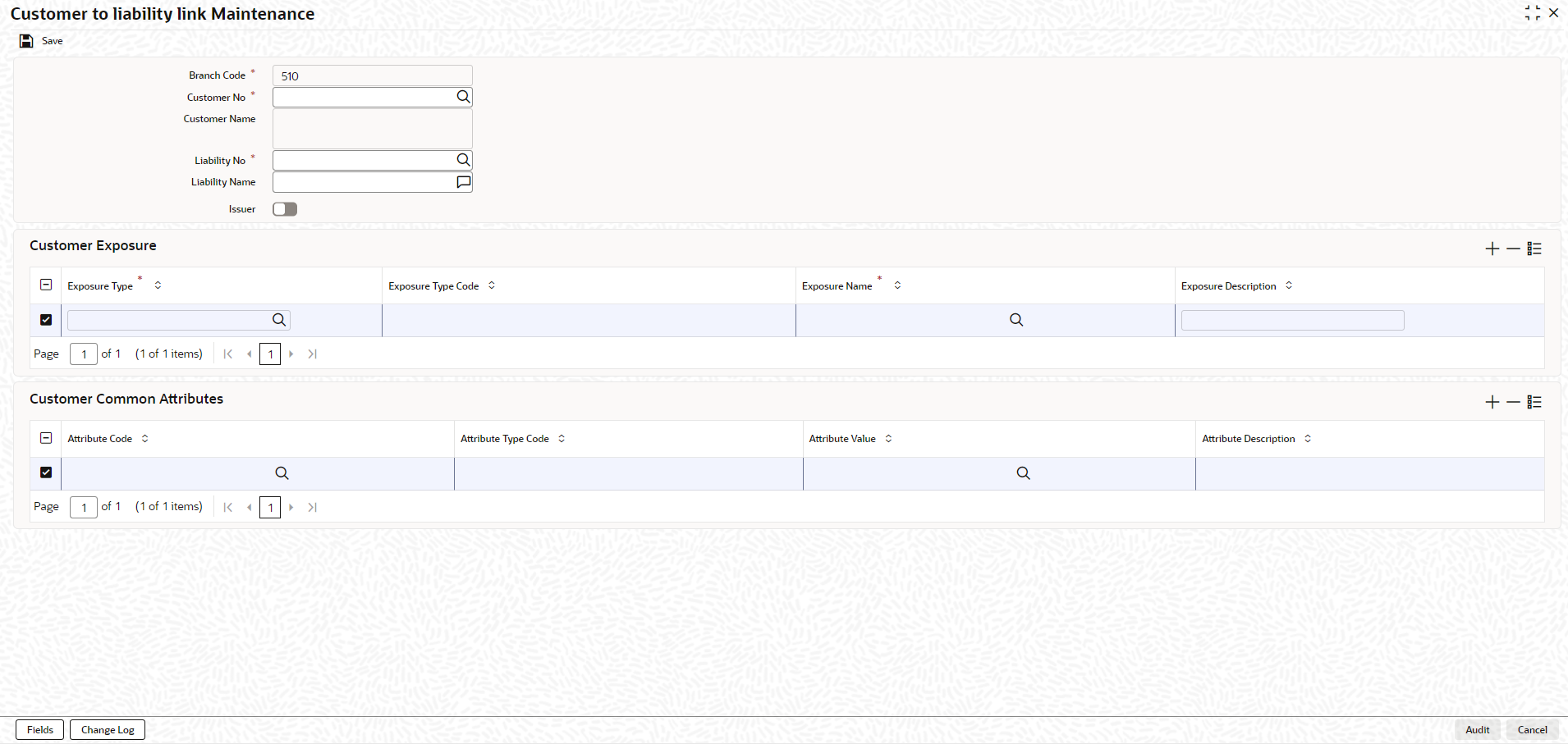

- On the Home screen, specify
GEDCULIK in the text box and click the
icon.The Customer to Liability Link Maintenance screen displays.Figure 2-38 Customer to Liability Link Maintenance
- On Customer to Liability Link Maintenance screen, click
New and specify the fields.For more information on fields, refer to the field description table.
Table 2-34 Customer to Liability Link Maintenance - Field Description
Field Description Branch Code The branch code of the branch in which the customer to liability link maintenance is done gets defaulted. Customer No Click the
icon and select the customer number to which the
liability has to be linked.
Customer Name This field is automatically populated based on the selected customer number. Liability No Click the
icon and select the number of the liability to be
linked to the customer.
Liability Name This field is automatically populated based on the liability number. Issuer Customer Exposures Specify different Exposure Types for the customer. Exposure Type The exposure type for the exposure, as maintained in the Track Exposure Maintenance screen gets defaulted here based on the Exposure Name selected. Exposure Type Code The exposure type code to which the selected exposure type belongs gets defaulted. Exposure Name Select the required exposure name. The exposure codes maintained in the Track Exposure Maintenance and Bulk Track Exposure Input screen are listed in the list of values. Exposure Description The description for the exposure, as maintained in the Track Exposure Maintenance screen gets defaulted here based on the Exposure Name selected. Customer Common Attributes Specify the customer common attribute for the customer. Attribute Code Select the required attribute code from the list of values maintained in GEDTRKMT. Attribute Type Code This code gets defaulted based on attribute code selection. Attribute Value Select the required attribute value from the list of values maintained in GEDTRKMT. Attribute Description The description provided in GEDTRKMT for the selected attribute value gets defaulted. Note:
