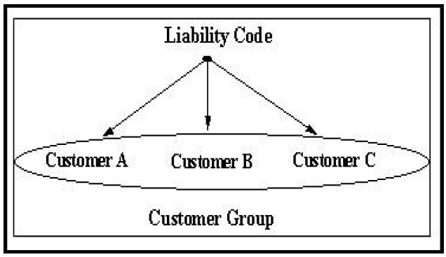

| Liability No
Specify the liability number. If the
liability number is customer group then all customers under
this group should have same liability number. |

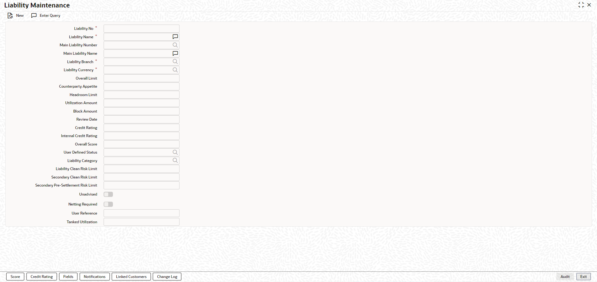

| Liability
Name |
Specify the liability name with maximum of
255 characters. |
| Main Liability Number
Click the icon and select the required main liability from
the list of liability numbers maintained in the system.
Note: Child liability and parent
liability (main liability) can be in different
branch.
During Utilization and block
transactions, the utilization and block amounts are
tracked for both the specified Liability and the linked
parent Liability.
After the child
liability creation, you can change or delink the
selected main liability through the Main
Liability Change screen GEDMLBCG,
if required.
If the main liability
is not selected during child liability creation, you can
link the main liability at any time through the
Main Liability Change screen
GEDMLBCG.
The child liability's overall limit amount should not
exceed the parent liability's overall limit
amount.
| Main Liability Name
This field is automatically populated based
on the selected from Main Liability
Number.
| Liability Branch
Click the icon and select the branch in which liability is
associated.
| Liability Currency
Click the icon and select the currency with which the
liability is associated. If Liability currency is different
from Limit currency specified in Global Exposure
Parameter, then the Liability amount is
converted to the limit currency.
Overall
limit amount $1 of the customer liability exceeds the
maintained Internal Lending Limit Equivalent Amount $2.
Note: User can modify the
liability currency after authorization if:
- There are no lines, collaterals or
collateral pools linked to the liability.
- The liability is not utilized.
- The liability is not the parent
liability for another child liability.
| Overall Limit
Main line limit cannot be more than overall
limit. Limit amount of line reporting to a liability cannot
be more than liability level limit amount.
Only the
parent facilities will be considered while validating
against the overall limit.
The system validates the overall limit amount with
the internal lending limit equivalent amount. If the
overall limit amount is greater than the Internal
Lending Limit Equivalent Amount, then the system
displays an override message as Overall limit amount
$1 of the customer liability exceeds the maintained
$2.
| Counterparty Appetite
Specify the total project limit which can be
sanctioned to the customer.
- It is not a mandatory field. Counter party
appetite is user enterable.
- If entered, cannot be less than the overall
limit .If not entered it is derived from the
overall limit.
- If entered more than overall limit, then it is
not derived from the overall limit.
| Headroom Limit
The system displays the future dated headroom
available to the customer. The headroom limit is updated
based on the limit amount of facilities created under the
liability.
Headroom limit will be updated as counterparty
appetite.
Headroom limit should be shown as ZERO
if it is negative. However internally it will be tracked
and suitably updated if any linked facility is
closed.
Note: Facilities
created under a child liability will update only the
headroom limit of child liability. Update on the
headroom limit of child liability will not affect the
headroom limit of the parent liability.
Sub-lines
will not update the headroom limit.
| Utilization Amount
This field displays the utilized amount for
that liability ID at any point in time. User cannot edit
this display. |
| Block Amount |
Specify the block amount. |
| Review Date |
Specify the date on which your bank would
want to review the limit for the liability. The limit check
continues irrespective of the date maintained here. The
revision date must be greater than the start date and can
also be left blank. |
| Credit Rating
The primary credit rating maintained in the
credit rating sub-screen is displayed.
Note: These
details are maintained only for information and have no
processing impact.
| Internal Credit
Rating |
The internal credit rating maintained in the
credit rating sub-screen is displayed. |
| Overall Score
Specify the overall credit score for the
liability. The given credit score is supplemented by the
multiple credit score details, if any entered in the
Credit Score
sub-screen.
Note: These details are
maintained only for information and have no processing
impact.
| User Defined Status
Click the icon and select the status of liability. (For
example, NORM for normal, BLOCKED,and so on).
| Liability Category
Click the icon and select the liability category from the
list available here. The Category
entered in Category Maintenance
| Liability Clean Risk
Limit
This limit is captured in the
Customer Maintenance screen
(STDCIF). This field is populated only when the
liability is created using Auto liability
Creation option in Customer
Maintenance screen.
Note: This field is only display field and
no other validations as such are supported.
| Secondary Clean Risk Limit
This limit is captured in the Customer
Maintenance screen (STDCIF). This field is
populated only when the liability is created using Auto
liability Creation option in Customer
Maintenance screen.
This field is
only display field and no other validations as such are
supported.
| Secondary Pre-Settlement Risk
Limit |
Maintenance screen.
This
field is only display field and no other validations as
such are supported.
| Unadvised
Switch to for this feature to be enabled.
Switch to for this feature to be disabled.
For any
transaction involving an unadvised liability, you are
notified.
| Netting Required
Switch to for the netting amount to be defined.
Switch to for not defining the netting amount.
This is only for information purpose and not
for processing.
User can have the Facility to display the
Netting Amount in the Netting
Contribution screen. For more details on
this feature, refer the Including Netting
Amount in Facility's Netting
Contribution topic.
Note: Limits tracking at liability
level is based on liability tracking at the
parametrization level.
- If the liability tracking is
enabled, then the system allows you to track the
limit at the liability level.
- Disabling liability tracking does
not allow tracking limits at liability level.
| Tanked Utilization
The system computes and displays the
utilization amount that can be set in the Tanked
Utilization field.
As part of
EOD process, the utilization amount is set in the
Tanked Utilization field.
After BOD process, this utilization
amount is updated for the liability which is linked to
the transaction as per the contract and the amount is
cleared from the Tanked
Utilization field.
