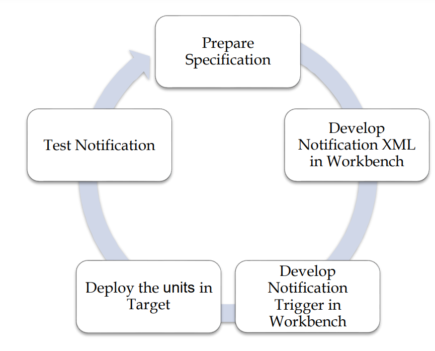

Figure 4-1 Architecture- Notification Development

Notification XML development
Notification RAD XML development creates the following files:
- RAD XML
- SPC
- SQL
- Static Data
Notification Process
