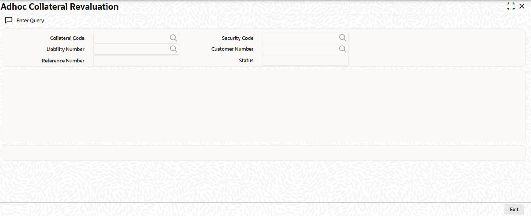

The Adhoc Collateral Revaluation screen provides an option to search and revaluate the market based collaterals with the latest price, if Revaluate Market Online is set as Batch in the Global Exposure Parameter Detail screen GEDPARAM.
  1. On the Home screen, specify GCDADREV in the text box and click the Next icon.
    The Adhoc Collateral Revaluation screen is displayed.
    Figure 2-1 Adhoc Collateral Revaluation
  2. On Adoc Collateral Revaluation screen, specify the fields.
    Table 2-1 Adoc Collateral Revaluation
    Field Description
    Collateral Code Select the collateral code of the market based collateral from the list of values.
    Security code Select the security code of the market based collateral from the list of values.
    Liability number Select the liability number associated with the market based collateral to be revaluated.
    Customer Number Select the customer number associated with the market based collateral to be revaluated.
    Reference Number The system generates a unique reference number for the adhoc revaluation and displays the same in this field, when the user clicks Process button.
    The user can also inquire the status of adhoc collateral revaluation by entering the reference number in this field.
    Status
    Displays the status of adhoc revaluation. Before initiating the revaluation, the system displays the status as Unprocessed as shown below:
    Figure 2-2 Adhoc Collateral Revaluation
    Once the Adhoc revaluation is completed, the status is updated as PROCESSED.
    Collaterals that are revaluated through adhoc revaluation process will follow the normal process of frequency based revaluation on the next revaluation date of the collateral.
