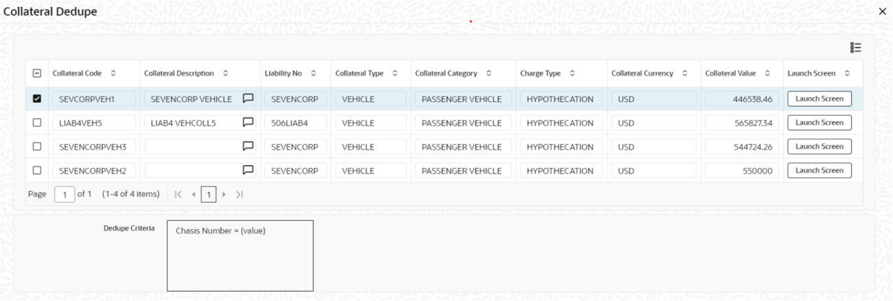

  4. Click Dedupe Check to identify whether the collateral to be created is duplicate or not. The system validates the existing collateral records using the parameters configured in Collateral Dedupe Maintenance screen.
    The Dedupe Check screen displays.
    Dedupe check must be individually performed for all the child collaterals.
    Figure 1-76 Collateral Dedupe Check
  5. Click Launch Screen to verify records and take necessary action.
  6. Click Ignore Dedupe & Proceed to ignore the dedupe check result and continue with collateral creation.
