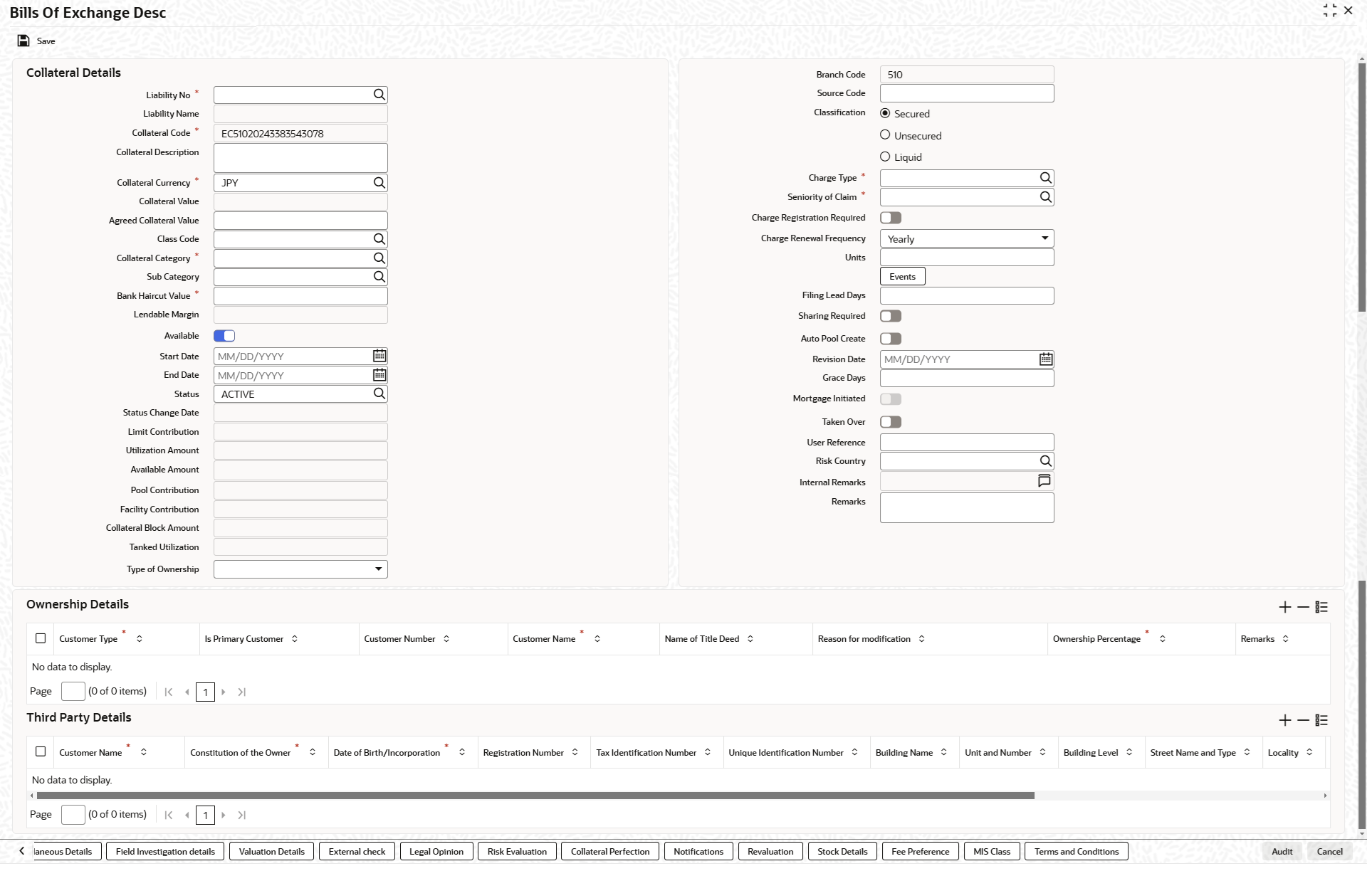

  1. On the Home screen, specify GCDCOLBE in the text box and click the Next icon.
    The Bill of Exchange Desc screen is displayed.
    Figure 1-89 Bill of Exchange Desc

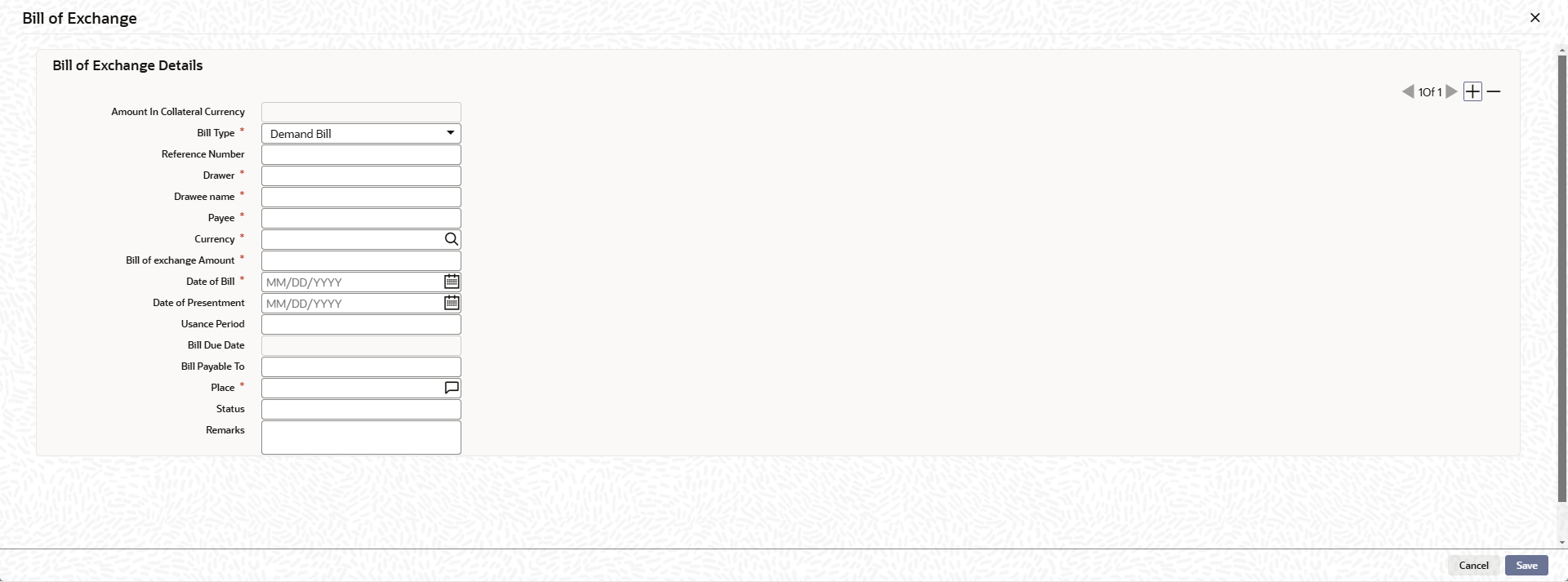

  2. On Bill of Exchange Desc screen , click the Bill of Exchange tab.
    The Bill of Exchange sub-screen is displayed. For more information on fields, refer to the field description table.
    Table 1-104 Bill of Exchange - Field Description
    Field Description
    Amount in Collateral Currency Bill of Exchange amount converted to collateral currency, if the bill of exchange currency and the collateral currency are different.
    Bill type Select the bill of exchange type from the drop-down list. The options available are:
    • Demand Bill
    • Usance Bill
    Reference Number Specify the reference number of the bill of exchange.
    Drawer Specify the name of the Entity issuing the bill of exchange.
    Drawee Name Specify the name of the bank at which the bill of exchange issued by the entity is to be drawn.
    Payee Specify th recipient or bearer of the bill of exchange.
    Currency Click the Search icon and select the currency of the promissory note.
    Bill of Exchange Amount Specify the amount mentioned in the Bill of exchange.
    Date of Bill Specify the date on which the bill of exchange is issued.
    Date of Presentment Specify the date of presentment for demand bill. This date is mandatory only if the Bill type is selected as Demand Bill.
    Usance period (Months) Specify the usance period in months. This date is mandatory only if the Bill type is selected as Usance Bill.
    Bill due date Due date of the bill of exchange.
    • For Demand Bill : Bill due date = Date of Presentment
    • For Usance Bill : Bill due date = Date of Bill + Usance period
    Bill Payable to Bearer/order of payee of the bill of exchange issued by the entity.
    Place Specify the place or address of execution of the bill of exchange.
    Status Selecy the status of the bill of exchange. The options available are:
    • Active - During new collateral creation process of bill of exchange, the Status will be selected as Active by default.
    • Settled: After saving the collateral, the bill of exchange can be marked / updated as Settled either manually by user or through an automatic update process based on the date captured as settled at any point during the collateral life cycle.
      Note: Collateral value will get reduced based on the individual status update of associated / linked bill of exchange.
    If the status is set to Settled, it cannot be changed as Active again.
    Remarks Specify the additional details of the bill of exchange, if any.
  3. Click Save to save the record.
