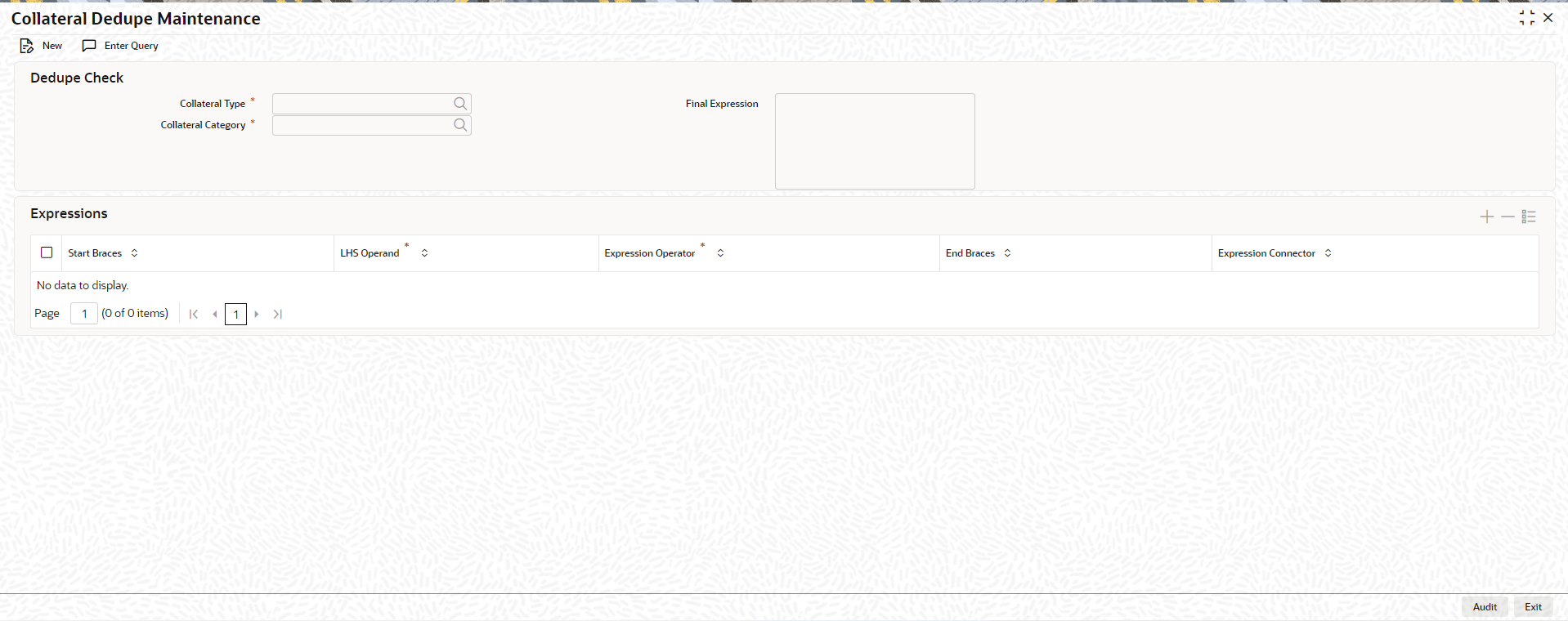

  1. On the Home screen, specify GCDDEDUP in the text box and click theNext icon.
    The Collateral Dedupe Maintenance is displayed.
    Figure 1-14 Collateral Dedupe Maintenance
  2. On Insurance Type Details screen, click New and specify the fields.
    Table 1-17 Collateral Dedupe Maintenance - Field Description
    Fields Description
    Collateral Type Click the Search icon and select the collateral type from the list. The available options are:
    • Property
    • Vehicle
    • Agriculture
    • Aircraft
    • Water Vessel
    Collateral Category Click the Search icon and select the category from the list. Collateral categories factory shipped for the selected Collateral Type are displayed in the drop-down list.
    Final Expression The system builds the Final Expression based on the provided expressions, on clicking Save in the Collateral Dedupe Maintenance screen.
    Note: Refer to Individual Collateral Maintenance section for deduplication check details.
    Expressions Specify the fields under this section.
    Start Braces Select the start braces from the drop-down list. The available options are:
    LHS Operand Click the Search icon and select the dedupe check parameter from the list.
    Expression Operator Select the operator from the drop-down list. The available options are:
    • Exact Match - The system will search and display all the existing collateral records with parameter value that exactly matches with the parameter value of record to be created as dedupe check result.
    • Probable Match - The system will search and display all the existing collateral records with parameter value that at least partially matches with the parameter value of record to be created as dedupe check result.
    End Braces Select the end braces from the drop-down list. The available options are:
    Expression Connector Select the expression connector from the drop-down list. The available options are:
    • AND
    • OR
  3. Click Save to save the record.
