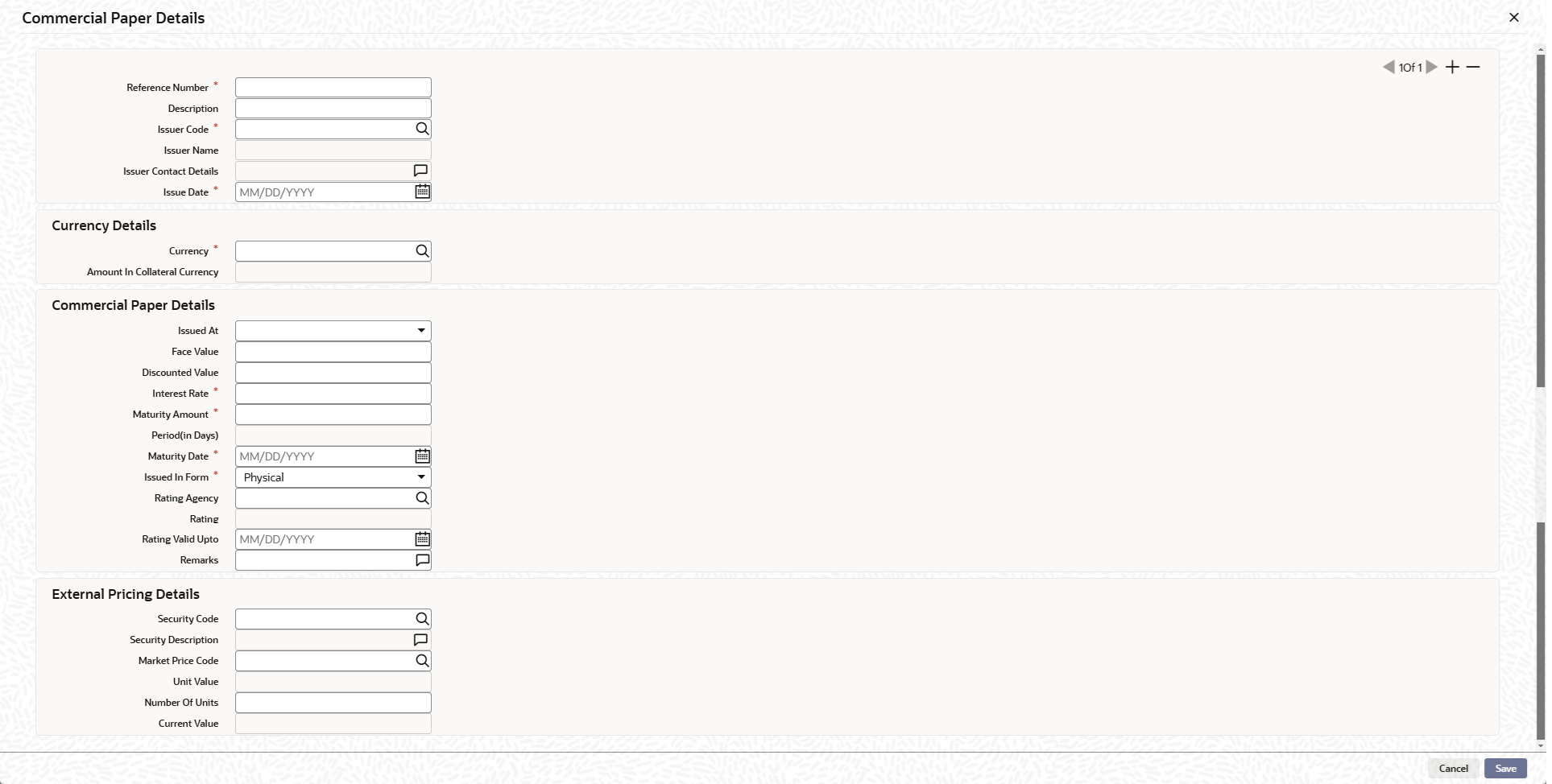

  1. On the Home screen, specify GCDCOLCP in the text box and click the Next icon.
  2. On Commercial Paper screen , click the Commercial Paper Details tab.
    The Commercial Paper Details screen is displayed.
    Figure 1-72 Commercial Paper Details
    Table 1-76 External pricing details - Field Description
    Field Description
    Security code When the collateral is enabled for external revaluation, click the Search icon and select the security code from the adjoining list.
    Security description Displays the description of the security code selected.
    Price code Click the Search icon and select the one or more price codes configured for this security code.
    Unit value Unit value is defaulted for the price code selected.
    Number of units Specify the number of units of security being considered for collateral creation.
    Current value Based on unit value and number of units, current value is calculated and displayed.
