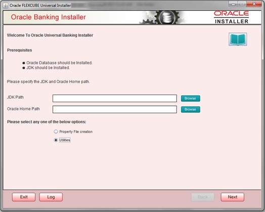

- Double-click the FCUBSInstaller.bat batch file to launch Oracle FLEXCUBE Universal Installer.Select the Utilities option and click the Next button.Oracle FLEXCUBE Universal Installer - Welcome screen is displayed.

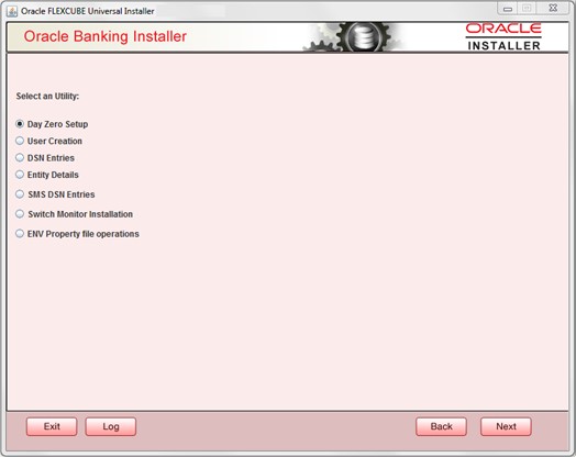

- Select Day Zero Setup in Utility Screen and click the Next button.Oracle FLEXCUBE Universal Installer - Select an Utility screen is displayed.
Figure 2-2 Oracle FLEXCUBE Universal Installer - Select an Utility

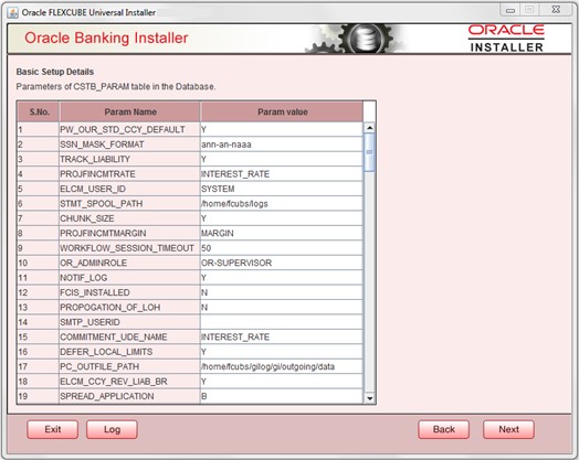

- The screen displays basic setup details for table CSTB_PARAM.
- Here Oracle directory name(present in all_directories table in the schema) must be added for WORK_AREA and TRACE_AREA. Oracle directory name must be added for other required parameters also.
- Oracle directory creation in the schema can be done as below :Create or replace directory dir_name as directory_path.
If the target database is Autonomous Database then WORK_AREA and TRACE_AREA value should be blank, and USERDEBUGMODE must be given as DB for Autonomous Database. - Click on the Next button to display the LIMITS INTEGRATION PARAMETERS screen.Oracle FLEXCUBE Universal Installer - LIMITS INTEGRATION PARAMETERS screen is displayed.

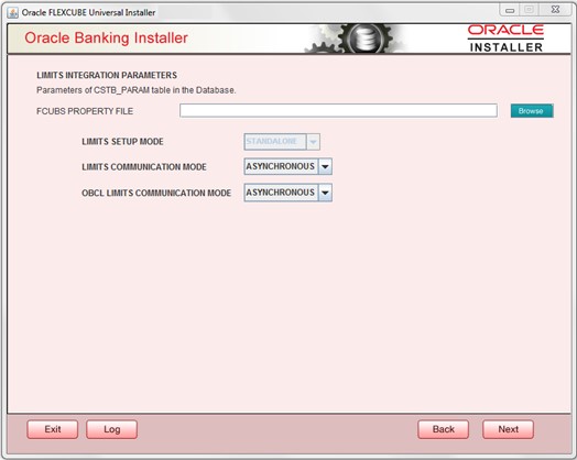

Figure 2-5 Oracle FLEXCUBE Universal Installer - LIMITS INTEGRATION PARAMETERS
- The Limits Integration Parameters will be set based on values read from fcubs.properties file browsed.In the case of ELCM Embedded, the Limit Communication mode will be Asynchronous by default. These parameters will be updated in the CSTB_PARAM table.

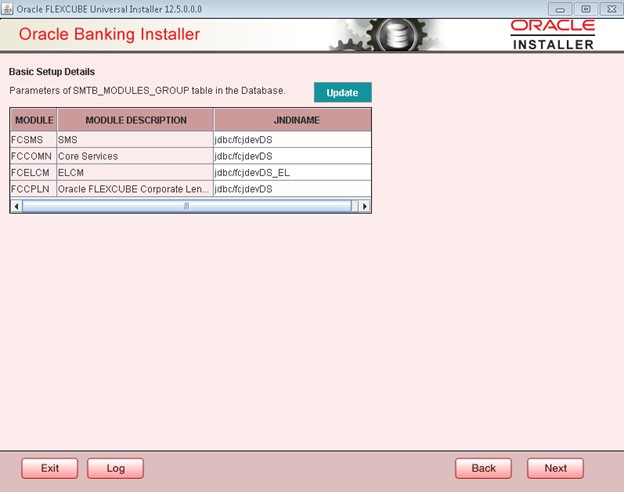

- Click on the Next button. The screen displays parameters for table SMTB_MODULES_GROUP.If any change is required in the JNDI name, edit the same and click on Update.
SMTB_MODULES_GROUP for FCELCM (Oracle ELCM) with the JNDI name ‘_EL.’ For example, if the ENTITY_ID JNDI name is jdbc/fcjdevDS, then you need to update the JNDI name jdbc/fcjdevDS_EL.Figure 2-6 Oracle FLEXCUBE Universal Installer - Basic Setup Details - SMTB_MODULES_GROUP

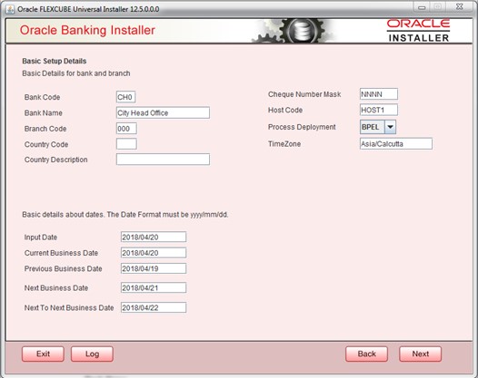

- Click the Next button.Oracle FLEXCUBE Universal Installer - Basic Setup Details - Bank and Branch screen is displayed.
Figure 2-7 Oracle FLEXCUBE Universal Installer - Basic Setup Details - Bank and Branch
- On the Oracle FLEXCUBE Universal Installer - Basic Setup Details - Bank and Branch screen, specify the bank, branch and date details.
Table 2-3 Basic Setup Details - Bank, Branch and Dates
Fields Description Bank Code Enter the bank code. Bank Name Enter the bank name. Branch Code Enter the branch code. Country Code Enter the Country code. Country Description Enter the Country Description. Cheque Number Mask Enter the Cheque Number Mask. Process Deployment Choose mode of process deployment between BPMN Input Date Enter the input date. Current Business Date Enter the current business date. Previous Business Date Enter the previous business date. Next Business Date Enter the next business date. Next to Next Business Date Enter the next to next business date. - Click the Next button.Oracle FLEXCUBE Universal Installer - Basic Setup Details - Currency Details screen is displayed.

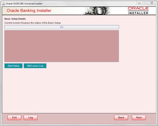

Figure 2-9 Oracle FLEXCUBE Universal Installer - Basic Setup Details - Status

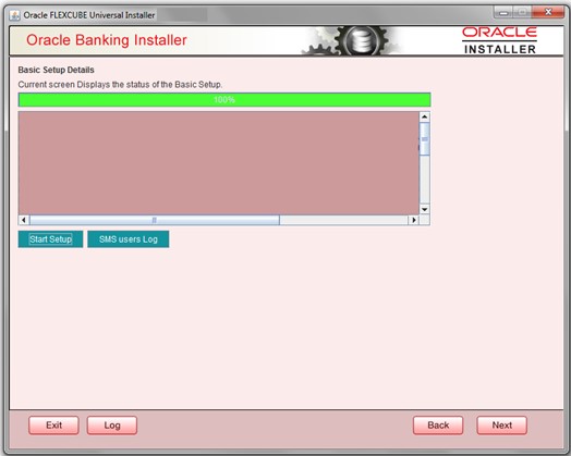

- Click the Start Setup button to compile the entries. On completion, the below screen will be seen. User created logs can be viewed by clicking the SMS users Log button.Oracle FLEXCUBE Universal Installer - Basic Setup Details - Status Completed screen is displayed.
Figure 2-10 Oracle FLEXCUBE Universal Installer - Basic Setup Details - Status Completed
