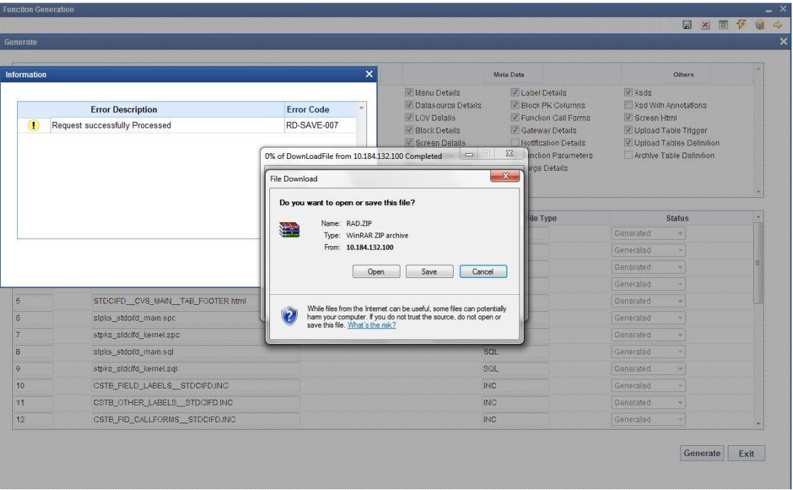

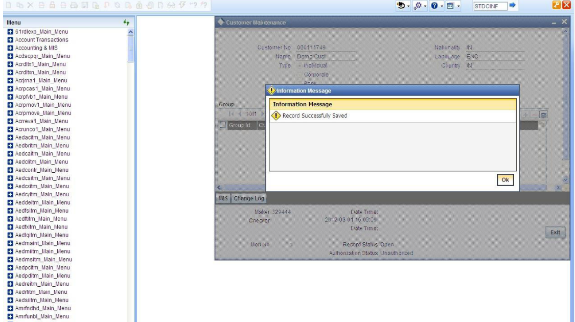

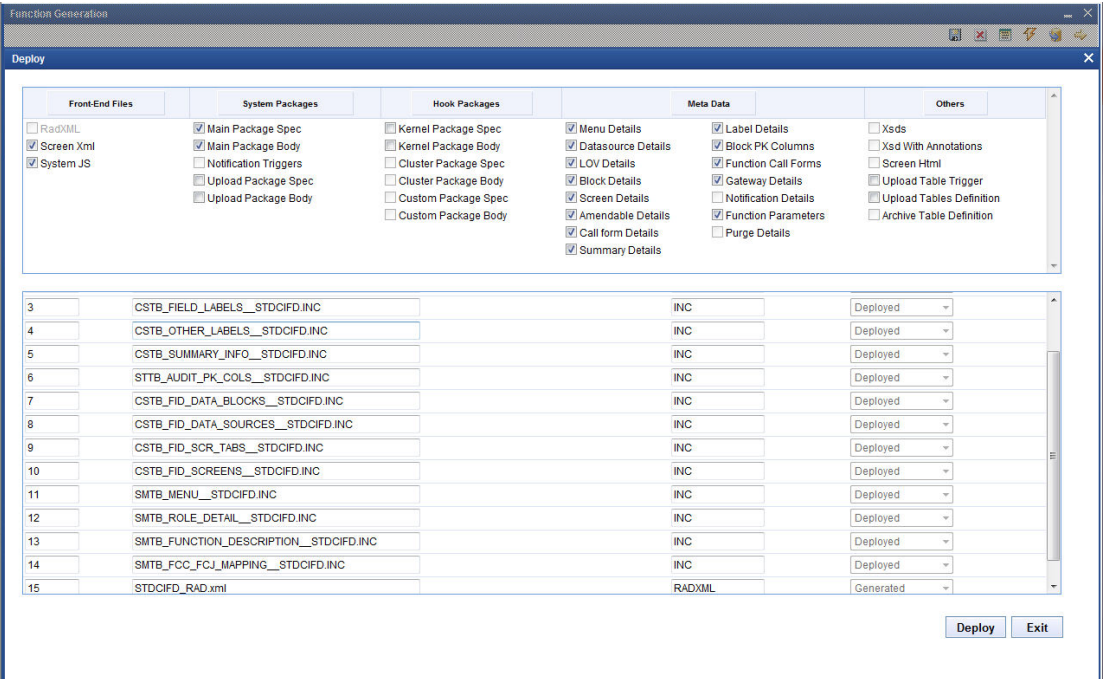

15 Generate and Deploy Files This topic explains systematic instructions to generate and deploy files. To generate files, click Generate.The Generate screen displays. Figure 15-1 GenerateDescription of "Figure 15-1 Generate" Select the required files to generate, and click on Generate button.The Information window displays with the status. Figure 15-2 InformationDescription of "Figure 15-2 Information" To deploy files, click on the Deploy button.The Deploy screen displays. Figure 15-3 DeployDescription of "Figure 15-3 Deploy" Select the required files to be deployed to the server and then click on Deploy button.The Information window displays with the status. Figure 15-4 InformationDescription of "Figure 15-4 Information"On successful deployment, status will be displayed as deployed. For testing, launch the screen from FLEXCUBE and try sample operations on the screen (NEW, MODIFY, QUERY, etc.)
