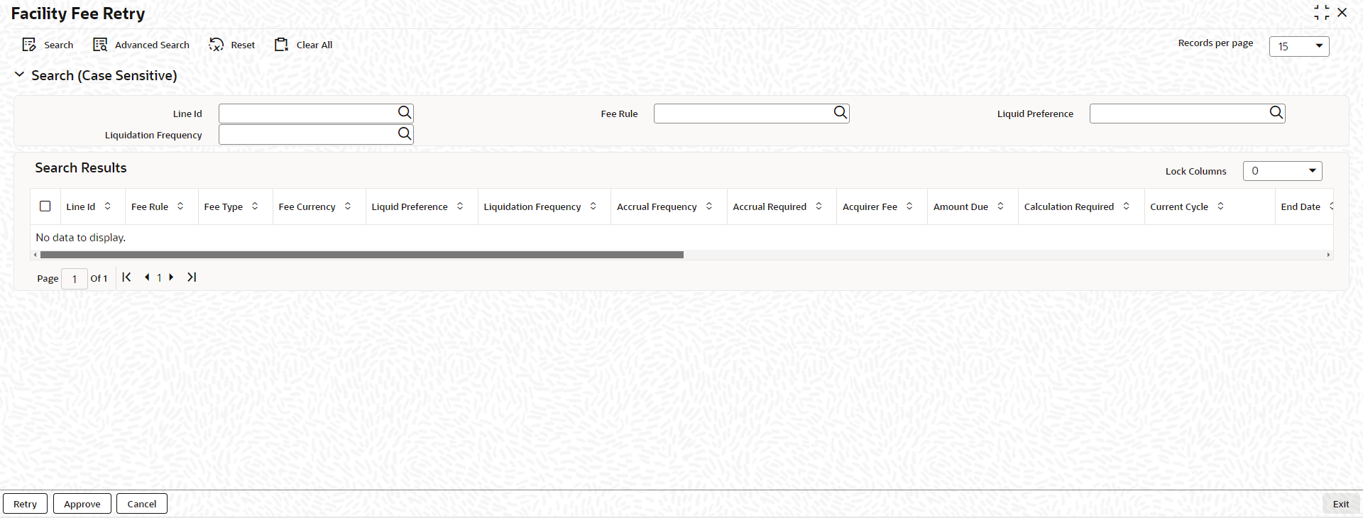

The Facility Fee Retry screen GESFRTRY lists down the facility fees which are configured as auto liquidation and are rejected during ECA request or failed due to other reason, irrespective of ECA configuration.
The user can use this functionality GESFRTRY to Approve / Retry the Rejected ECA request.
The fees rejected due to unavailability of funds can be re-triggered for liquidation once the balance is available in CASA of the customer and/or the fee that failed due to other reason can be retried for liquidation, by selecting the retry option.
The failed / rejected fees can be liquidated and force posted irrespective of available balance in CASA, by selecting the Approve option.

  1. On the Home screen, specify GESFRTRY in the text box and click the Next icon.
    The Facility Fee Retry screen is displayed. For more information on fields, refer to the field description table.

    • Multiple fees associated with the facility that has been rejected as part of ECA request can be selected at once and ECA request can be triggered.
    • As the screen displays all the fees for all the rules associated with the facility Id, retrying any one of the rule id will retrigger all the rejected fees with the facility.
    • You cannot change the liquidation preference opted as Full / Partial at facility level from this screen.
    • For the successful ECA request for which response is APPROVED, the fees are cleared off from the Facility Fee Retry screen. Whereas, the rejected ECA request (response as REJECTED) and / or the fees that gets failed again are continuously displayed in the Facility Fee Retry screen.
    • FLIQ will get triggered for these fees as part of APPROVE / RETRY process along with the related accounting entries.
