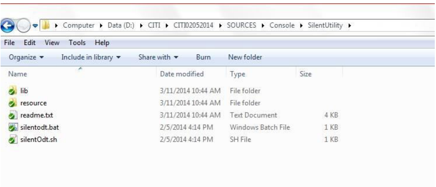

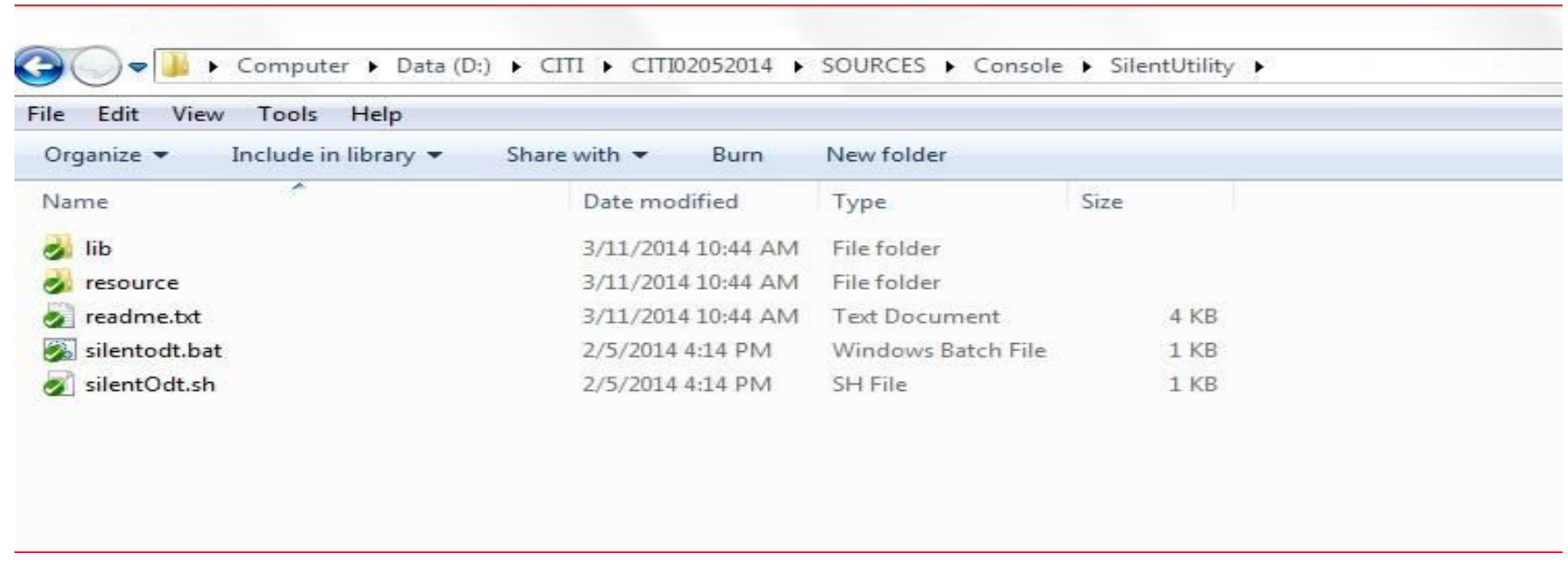

After copying the installer sources and library folder to the local system, make sure to uncheck the read-only check box in source properties and apply the same to all the subfolders.
Figure 6-1 Source Folder of SilentODTUtility

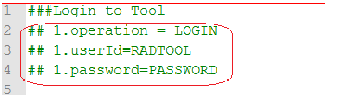

LOGIN and SETRELEASE are mandatory operations to be performed.- LOGINLogin should always be the first operation to be configured as part of any execution.
Table 6-2 Login to Tool

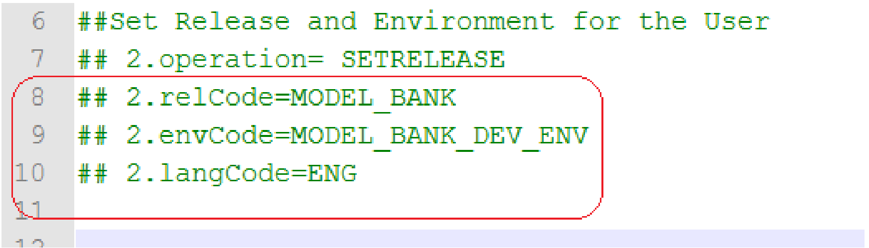

Field Description Operation LOGIN User Id ODT User Id which is created in the ODT Application. Password ODT Password which is created in the ODT Application (should be encrypted using Utility). - SETRELEASEThis operation is used for setting Release and Environment Preferences for SilentODTUtility. Connection to the FLEXCUBE schema would be established based on data maintained in ODT or through the data in env_config.xml as explained in an earlier section.
Table 6-3 Release and Environment Details for User
Field Description Operation SETRELEASE relCode ODT Release Code which is created in the ODT Application. envCode ODT Environment Code which is created in the ODT Application. langCode Lang code for the above-mentioned release code. - REST_GENERATIONWeb service artifacts can be generated through this operation.

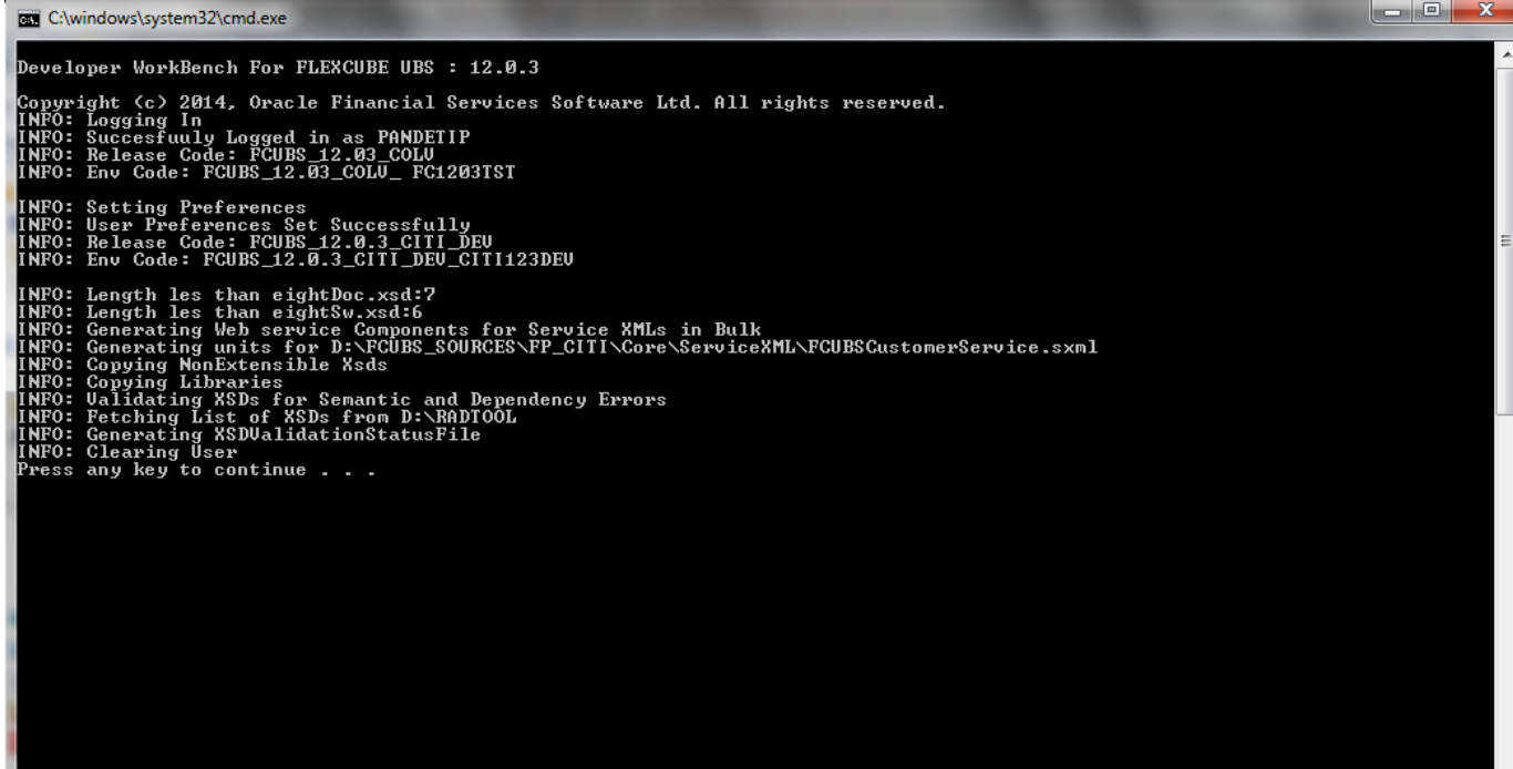

Generation of Rest service Artifacts through SilentOdtUtility
To generate Rest service artifacts for a service, configure the property files of the utility as explained in the previous section.
- LOGIN
- SETRELEASE
- REST_GENERATION
