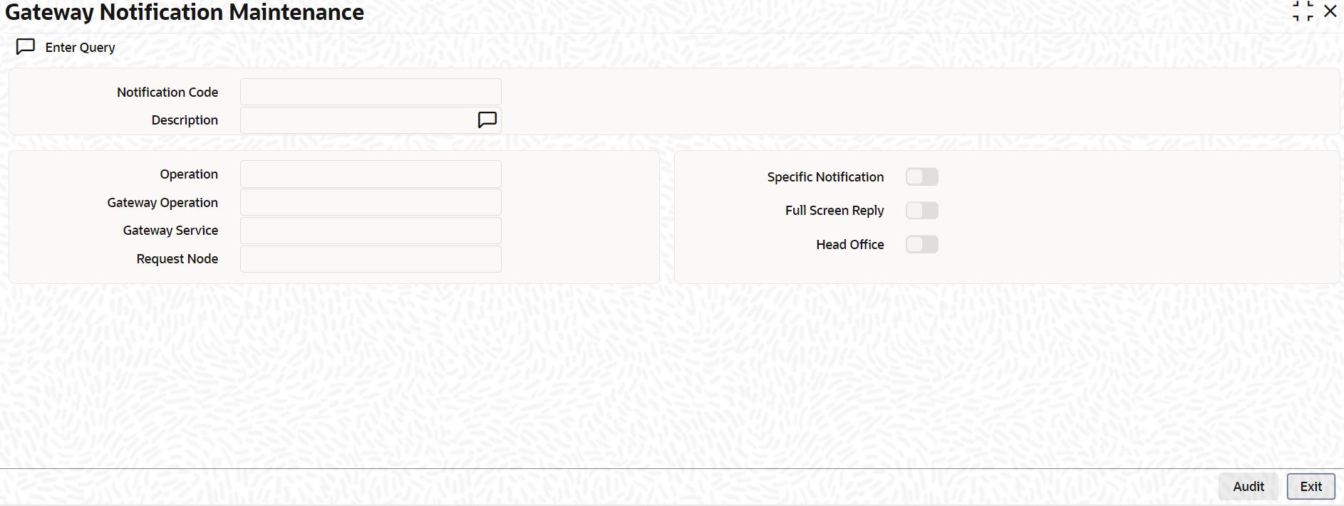

The user can view and amend certain notification parameters in Oracle FLEXCUBE Universal Banking using the Gateway Notification Maintenance screen.
  1. On Homescreen, type IFDNOTIF in the text box, and click Next.
    The Gateway Notification Maintenance screen displays.
    Figure 2-5 Gateway Notification Maintenance
  2. On the Gateway Notification Maintenance screen, specify the fields.
    The fields, which are marked with an asterisk, are mandatory.
    Table 2-5 Gateway Notification Maintenance - Field Description
    Field Description
    Notification Code The system displays a unique code to identify a notification.
    Description The system displays a brief description of the notification. However, the description can be modified on this screen.
    Operation Select the type of operation for the notification from the drop-down list:
    • Insert - To indicate a new operation of notification function.
    • Update - To indicate a modification operation of notification.
    Gateway Operation Specify the gateway operation name to execute the query for the mentioned service.
    Gateway Service Specify the gateway service to be used to get the full screen response.
    Request Node Specify the gateway IO request node to be used in the querying operation.
    Specific Notification Check this box to indicate the system to send a specific notification. The system handles any deviation from the generic notification process by creating specific triggers once this field is checked.
    Full Screen Reply Required Check this box to indicate that the full-screen notification response has to be sent. Otherwise, the primary key response notification is sent.
    Head Office Check this box to send notification only from head office.
  3. Click Exit to end the transaction.
