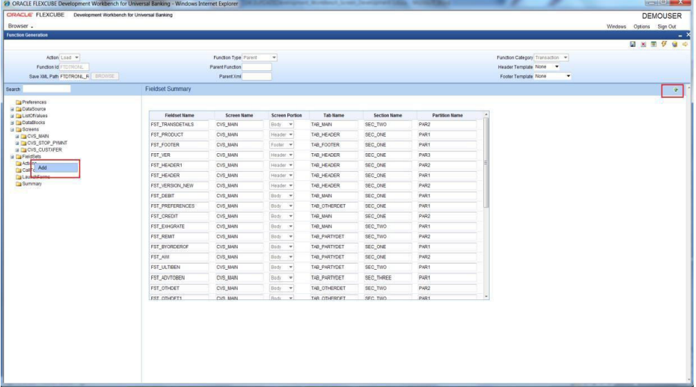

- Right-click on the Fieldset Node and select Add Field Set option from the right-click menu.
- Or click on the Add Fieldset (+) icon in the top right corner of the Field Set Screen.
Add FieldSet window displays.
- Specify the FieldSet Name field and click on the OK button.The standard naming convention for fieldsets is FST_< Descriptive Code of the Field Set>.For Example: FST_VERSION
