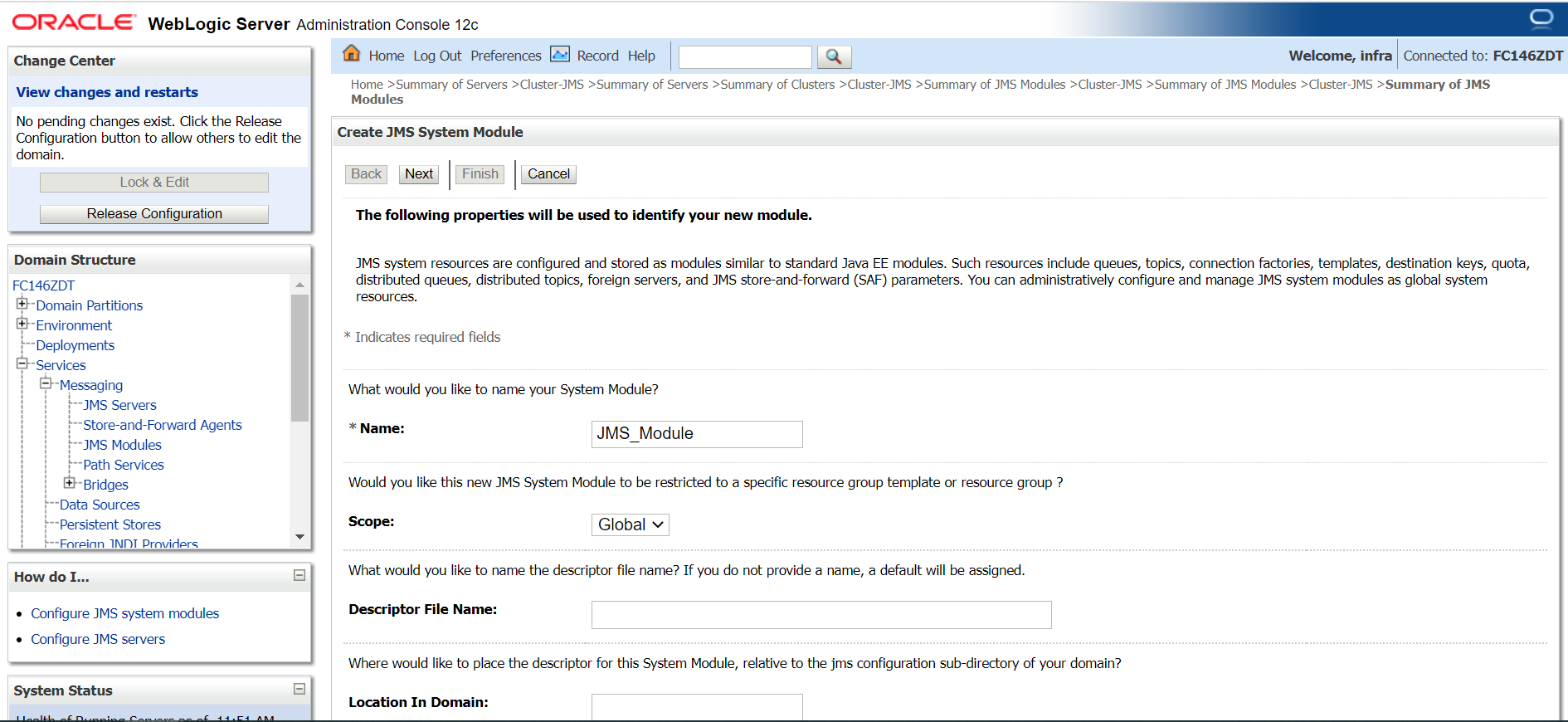

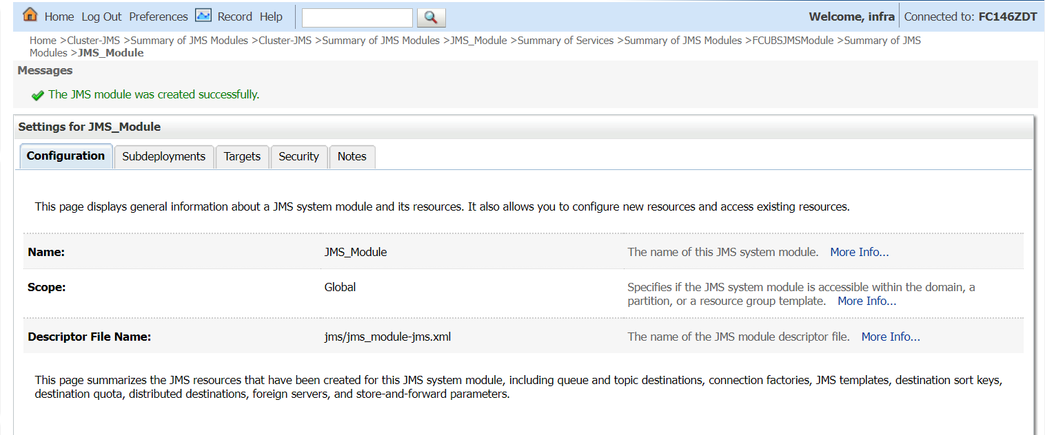

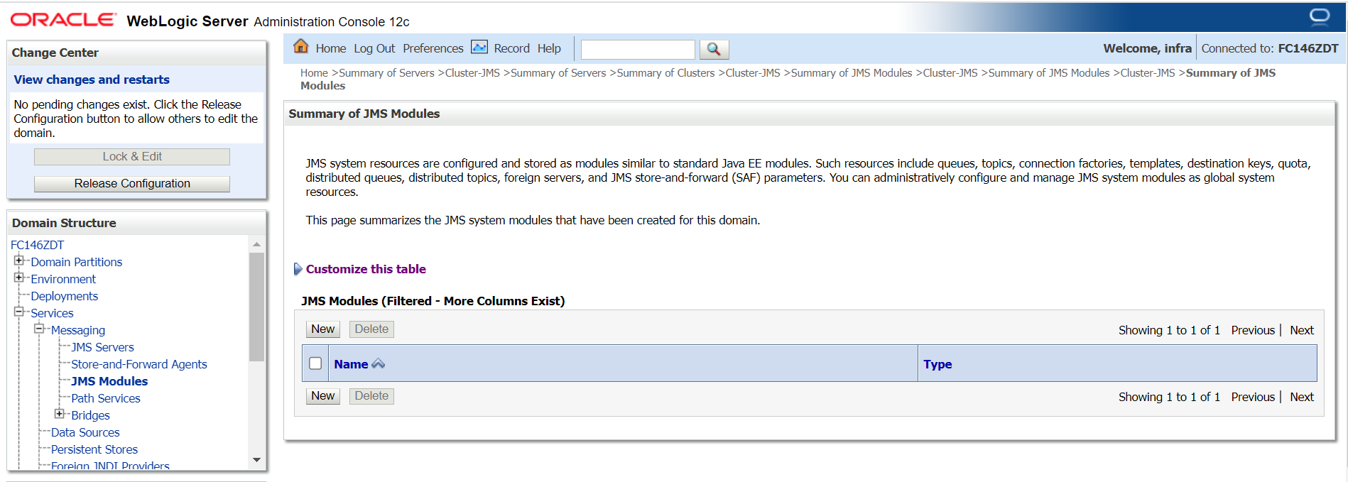

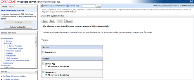

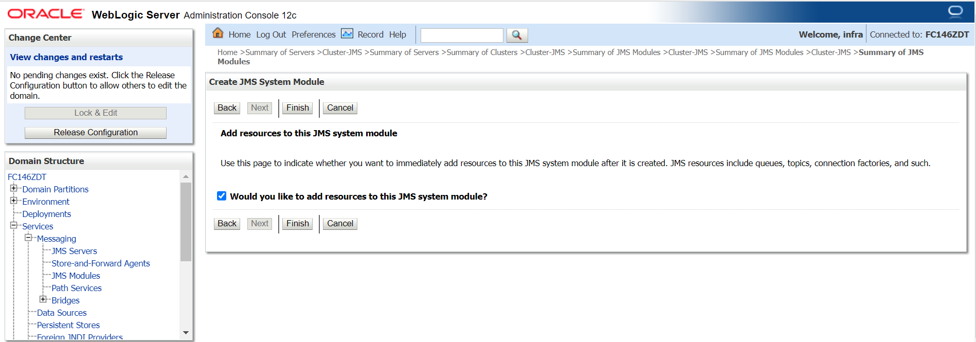

5.1 Create JMS Module This topic explains systematic instructions to create the JMS Module. Under the Domain Structure left panel, navigate to the Services drop-down option, and click Messaging, and then JMS Modules.The Summary of JMS Module screen displays. Figure 5-1 Summary of JMS ModuleDescription of "Figure 5-1 Summary of JMS Module" Click New under the JMS Module tab. The Create JMS System Module screen displays. Figure 5-2 Create JMS System ModuleDescription of "Figure 5-2 Create JMS System Module" Enter the Name as JMS_MODULE, and click Next.The Targets tab displays under the Create JMS System Module screen. Figure 5-3 TargetsDescription of "Figure 5-3 Targets" Select the target as Cluster-JMS, and then click Next.Add resources to this JMS system module tab displays under the Create JMS System Module screen. Figure 5-4 Add resources to this JMS system moduleDescription of "Figure 5-4 Add resources to this JMS system module" Select the check box, and click Finish.The JMS_MODULE is created. Figure 5-5 Settings For JMS_MODULE - MessagesDescription of "Figure 5-5 Settings For JMS_MODULE - Messages" Parent topic: Introduction
