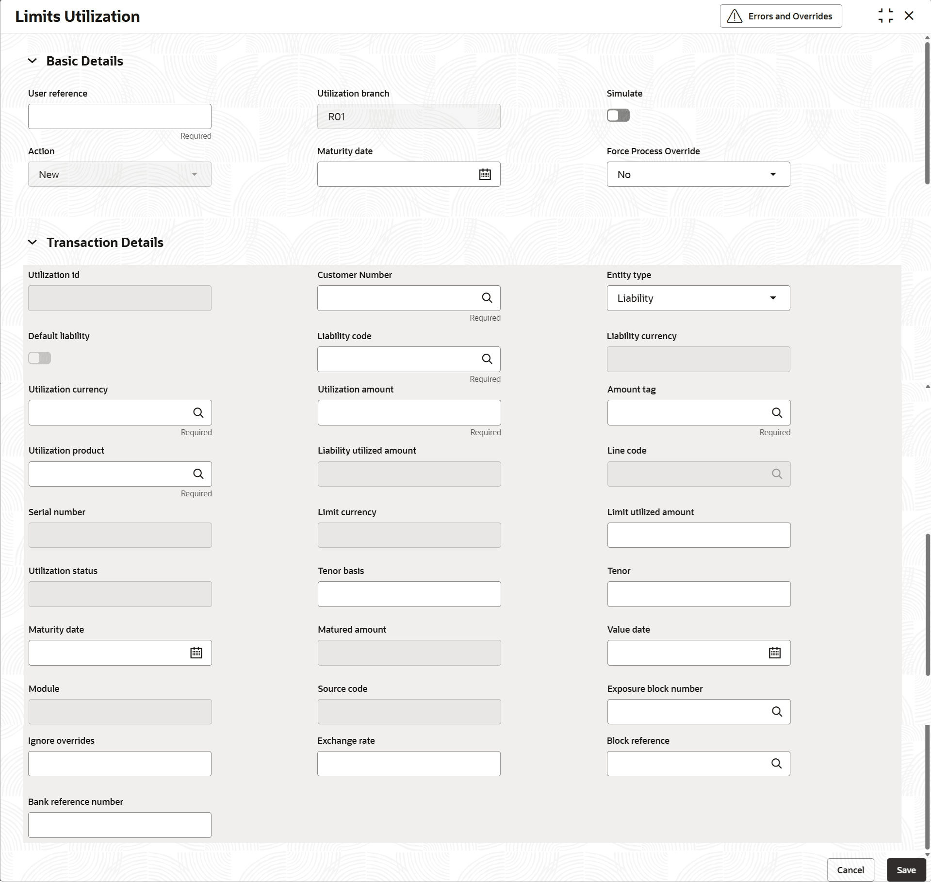

TheLimit Utilization screen is a screen for capturing utilization request specific to liabilities and facilities in Enterprise Limits System.
  1. On Home screen, select Limits and Collaterals. Under Limits and Collaterals, select Limits.
  2. Under Limits select Transactions. Under Transactions, select Limit Utilization.
    The Limit Utilization screen is displayed.
  3. On Limit Utilization screen, specify the fields.
    Table 2-67 Limit Utilization - Field Description
    Field Description
    User Reference Specify the unique number which is to be assigned for every utilization contract. Usually, User reference Number is the actual contract number in external system which is placing the utilization

    Maturity Date Specify the date on which the transaction matures. This is contract attributes sent by external product processors
    Force Process Ovd This is for checking the error type of the error codes raised during transaction - online or batch. Possible values are N (Online) and B (Batch).
    Utilization ID Click Save, the system generates the Utilization ID. Save.
    Customer Number Specify the Customer Number of the utilization transaction. Customer Number entered should be valid Customer Number in Oracle Banking ELCM system
    Entity Type Select the limit type from the drop down list. The options available are:
    • Liability
    • Facility
    Default liability
    Switch to On to enable this parameter. When a customer number is selected from drop-down list, default liability toggle is enabled by default and Liability No column shows the liability to which this customer is linked as default.
    Switch to Off to disable this parameter. If a customer is linked to multiple liabilities and utilization transaction needs to consider the entity belonging to a liability which is not default, then default liability needs to be disabled and liability number can be selected from drop- down list against this field. This gets disabled automatically when you select the non-default liability of the customer.
    Liability Code Click the Search icon and select the liability code from the list. All liabilities (default and non-default) to which a customer is linked are displayed
    Liability Currency Displays the currency the selected liability code.
    Utilization Currency Click the Search icon and select the currency for the utilization transaction. The adjoining option list contains all the currencies maintained in the system
    Utilization Amount Specify the amount for the utilization transaction.
    Note: For sub-line utilization on the main line, the system considers both the main-line's NRS available and available amounts.
    During utilization of block amount in NRS line, NRS amount is considered first if de-utilization transaction is done on the same day.
    Amount Tag Click the Search icon and select the amount tag from the list. The Amount Tag entered in Amount Tag Maintenance screen is displayed here. This typically indicates the type of the component of the transaction such as PRINCIPAL AMOUNT.
    Utilization Product Click the Search icon and select the product for the transaction. The adjoining option list contains all the relevant products. This indicates external product code initiating the utilization transaction.
    Liability Utilized Amount The system displays the utilization amount in liability currency.
    Line Code Click the Search icon and select the line code to be used for the transaction. The adjoining option list contains all the line codes allowed. This option is required when you select Entity Type as ‘Facility’
    Serial No The Serial Number field is disabled and it gets defaulted from the Facilities Maintenance screen.
    Limit Currency This field displays the limit currency of the entity (Liability or Facility)
    Limit Utilized Amount Specify the amount utilized from the limit in limit currency.
    • As part of a Direct cross-currency utilization transaction, this accepts the utilization amount in limit currency and uses that directly instead of deriving it based on the utilization amount in transaction currency and the exchange rate.
    • If the Limit Utilized Amount is specified, currency revaluation is not applicable for the utilization transaction.
    Utilization Status Indicates the utilization status. The options are:
    • Active (A)
    • Reverse (R)
    • Liquidated (L)
    Tenor Basis Select this check box to indicate that the utilization should be tracked tenor wise for the facility. You can specify the basis on which it is to be tracked in the Tenor field. Refer to Facility Tenor Restriction Maintenance.
    Tenor Enter the basis on which tenor tracking should be done for the utilization. You need to check the Tenor Basis option before you specify the basis here. For more details, refer to Facility Tenor Restriction Maintenance.
    Maturity Date Specify the date on which the transaction matures. This is contract attributes sent by external product processors.
    Matured Amount Specify the maturity amount of the transaction. This is contract attributes sent by external product processors.
    Value Date Specify the value date for the transaction. System supports both current dated and back dated block transactions.
    Module The module from which the transactions are triggered is displayed here. This is typically the associated module of the product processor which initiates the transaction.
    Source Code Indicates the product processor name from where the transaction has been originated. This field will be as part of Header section (Source Code).
    Ignore Overrides Specify whether the transaction should ignore the overrides occurred in the process or not.
    Example - an overdrawn transaction.
    Possible values “Y” (force authorize) and “N” (not force authorized).
    Exchange Rate Specify the Exchange Rate for cross currency utilization transaction. The utilization amount for the Limit Entities Facility, Pool, Liability, and Exposure linked to liability and facility will be calculated in the mentioned utilization currency directly using this exchange rate instead of the exchange rate mentioned in Config Service.
    If utilization amount is in limit currency and the Exchange Rate is not provided as a part of utilization, then the system will calculate the Exchange Rate with the utilization amount in transaction currency and the utilization amount in limit currency.
    Note: The exchange rate mentioned in Facility Utilization will be used only for the calculation of direct limit entities utilization. For more details, refer to Common User Guide for Exchange Rate in Cross Currency section.
    Block Reference Click the Search icon and select the block reference from the list.
    If you enter the block reference number, you can utilize the facility amount to extend of block amount. On utilization of block amount, the extent of the amount utilized is released from the block amount, thus the block amount is reduced.
    If you try to utilize more than facility amount, the system gives an override.
    An error appears, when you try to utilize more than blocked amount by providing block reference number.
    • The system posts amount to contingent accounts to the extent of reduction of available balance and does not consider the utilization from NRS Available balance.
    • For backdated utilization transaction, contingent entry is triggered only if the utilization is partially or fully serviced out of Available balance on back date. If utilization is serviced entirely out of NRS Available balance on back date, contingent entry is not triggered.
    • Reversal of earlier de-utilization transaction triggers contingent entries in case there is subsequent utilization transactions that were serviced out of NRS available balance, as subsequent utilization will impact the available balance and lead to UTIL increase due to reversal.
    • Reversal of utilization transaction triggers contingent entries only if utilization is partially or fully serviced out of Available balance. If utilization is serviced entirely out of NRS Available balance, contingent entry is not triggered.
    Block Reference Number Specify the block reference number.
