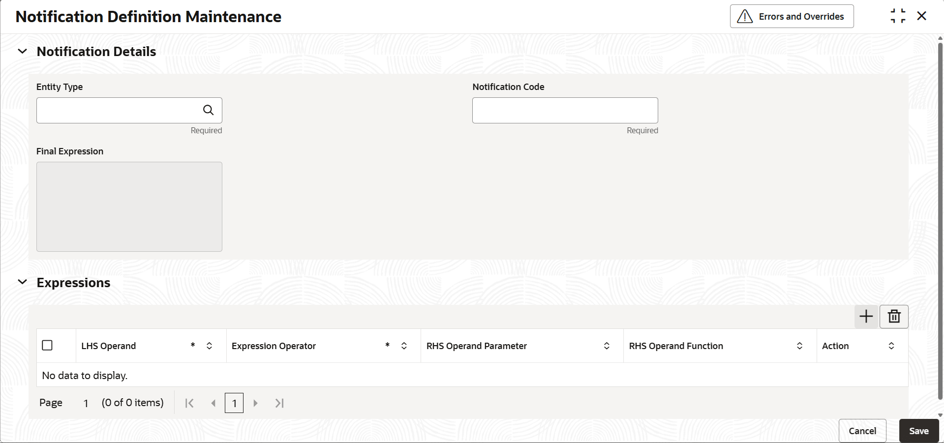

  1. On Home screen, select Limits and Collaterals. Under Limits and Collaterals, select Common. Under Common, select Maintenances.
  2. Under Maintenances, select Notification Definition. Under Notification Definition, select Notification Definition Maintenance.
    The Notification Definition Maintenance screen is displayed.
    Figure 4-1 Notification Definition Maintenance
  3. On Notification Definition screen, specify the fields.

    Final Expression Displays the Final Expression built based on the details provided in Expressions section.
    Expressions This section allows the user to directly provide the actual expression for defining notification.
    Press ‘+’ to add an expression.
    Start Braces Select the Start Braces (open parenthesis) for the expression from the drop down list.
    LHS Operand Select the attribute of the entity for defining the expression. For more information on conditions, refer Table11-2
    Expression Operator Select the arithmetic and relational operator for the expression. For more information on Expression Operator, refer Table11-3.
    RHS Operand Parameter Select the attribute of the entity or any predefined special values of the same data type as that of the LHS Operand for the expression, if required. For more information on RHS Operand Parameter, refer Table11-4.
    RHS Operand Function Select the RHS operand function for defining the expression. For more information on RHS Operand Function, refer Table11-5.
    RHS Operand Value Specify the RHS Operand Value of data type same as that of LHS Operand. Notification will be triggered when the LHS Operand and RHS Operand Value satisfies the defined expression.
    End Braces Select the End Braces (open parenthesis) for the expression from the drop down list.
    Expression Connector Select the connector to define another expression for the same notification. The options available are AND and OR. The connector “AND” is used to generate notification only if all defined conditions are met. When “OR” connecter is used the notification will be generated if any of the defined conditions is satisfied.

    ( Facility Credit Rating > Rating Priority PREVIOUS_VALUE - ) -
    Facility - Facilities which are expiring in next 30 days (RULE1)
    Table 4-16 Facility
    Start Braces LHS Operand Expression Operator RHS Operand Parameter RHS Operand Function RHS Operand Value Close Braces Expression Connector
    ( Line Expiry Date >= Application date ADDDAYS 0 - And
    - Line Expiry Date <= Application date ADDDAYS 30 ) -
    Facility - Limits where the Utilization Threshold% is breaching 80% of Sanctioned Limit (RULE3)
    Table 4-17 Facility
    ( Limit Amount > - GREATER_THAN 0 - And
    - Facility Util Amount >= Limit Amount PERCENTAGE_OF 80 ) -
    Facility - Facilities for which review due in the next 30 days (RULE5)
    Table 4-18 Facility
    ( Next Review Due Date >= Application date Add Days 0 - And
    - Next Review Due Date <= Application date Add Days 30 ) -
    Collateral – Collaterals which are expiring in next 20 days (RULE2)
    Table 4-19 Collateral
    ( Collateral End Date >= Application date Add Days 0 - And
    - Collateral End Date <= Application date Add Days 20 ) -
    Collateral - Collaterals where the Utilization Threshold is breaching 90% with respect to collateral value (RULE4)
    Table 4-20 Collateral
    ( Collateral Value > - GREATER_THAN 0 - And
    - Util Amount >= Collateral Value PERCENTAGE_OF 90 ) -
    Collateral - Collaterals where the market price becomes less than the most recent historical price (RULE9
    Table 4-21 Collateral
    ( Security Price < Market Price PREVIOUS_VALUE - ) -
  4. Click Save to save the record.
