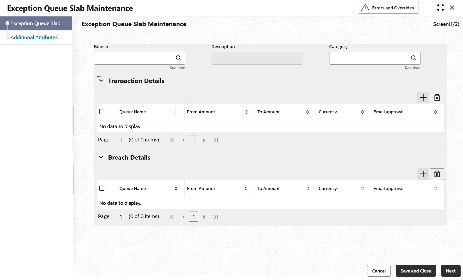

    The Exception Queue Slab Maintenance screen is displayed.
    Figure 1-58 Exception Queue Slab Maintenance
  4. On Exception Queue Slab Maintenance screen, click Add and specify the fields.
    Table 1-58 Exception Queue Slab Maintenance - Field Description
    Field Description
    Branch Click the Search icon and select the branch from the list.
    Description Displays the description of the branch selected.
    Category Click the Search icon and select the category for which the transactions authorize maintenance is being done. Having specified the category for the liability and the facility, the transaction authorize maintenance can be done for the same category. When the exception transaction Amount or exception breach percentage gets breached for a line belonging to the same category as defined in the transaction authorize maintenance, the transaction is available in the queue defined in the transaction authorize maintenance for the specific category.
    Transaction Details Specify the details under transactions.
    Queue Name Click the Search icon and select the queue name from queue maintenance for which amount slabs to be defined.
    From Amount and To Amount Specify the amount from and to range.
    Currency In this screen, while creating different slabs, the currency is defaulted from the Exception Queue Maintenance screen. This feature allows in picking appropriate queue based on utilization transaction amount in a particular currency. Thereby, dual authorization transaction can be sent to appropriate role.
    Email Approval
    Switch to On to send the mail to the users attached to role.
    Switch to Off to disable this parameter.
    Breached Details Specify the details under breached.
    Queue Name Click the Search icon and select the queue name.
    Email Approval
  5. Click Save and Close to save the added record. Click Next to navigate to the next screen.
