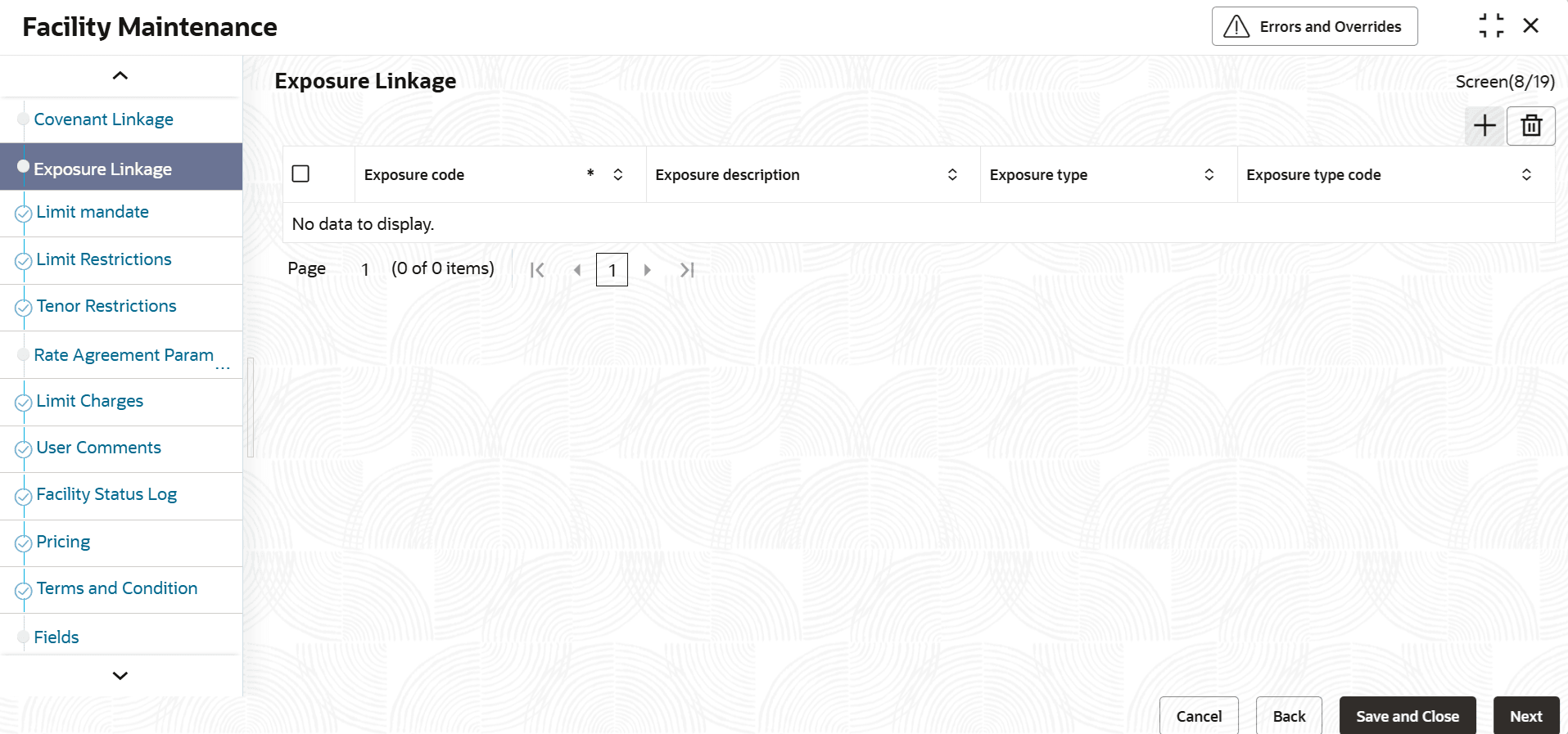

  1. Click Next in previous data segment to proceed with the next data segment, after successfully capturing the data.
    The Exposure Linkage screen is displayed.
    Figure 1-25 Exposure Maintenance

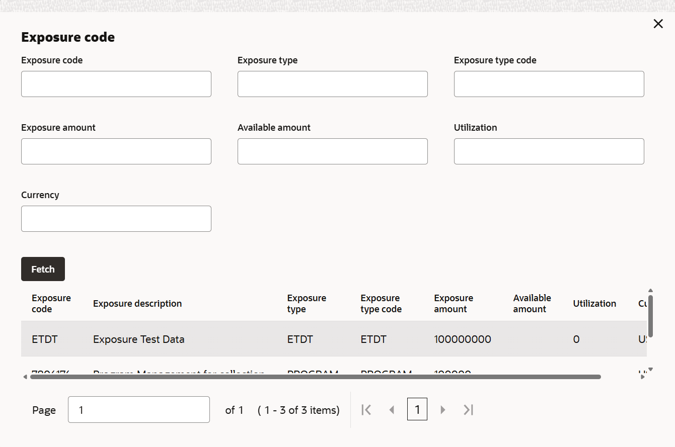

  2. Click Searchicon, the Exposure Code screen displays.
    For more information on fields, refer to the field description table below.
    Table 1-31 Exposure Code
    Fields Description
    Exposure Code Click the Search icon and select the exposure code from the available option list. The list displays the exposure codes maintained in Exposure Tracking Maintenance screen. Based on the exposure selected, all below details of the exposure maintenance are displayed.
    Exposure Type Displays the description based on the selected exposure code. You can use this to search for the required exposure code.
    Exposure Type Code
    Displays the type code based on the selected exposure code. You can also use this to search for the required exposure code.
    Exposure Amount Displays the exposure amount based on the selected exposure code. You can use this to search for the required exposure code.
    Available Amount Displays the exposure available amount based on the selected exposure code. You can use this to search for the required exposure code.
    Utilization
    Displays the exposure utilization amount based on the selected exposure code. You can use this to search for the required exposure code.
    Currency
    Displays the exposure currency based on the selected exposure code.
