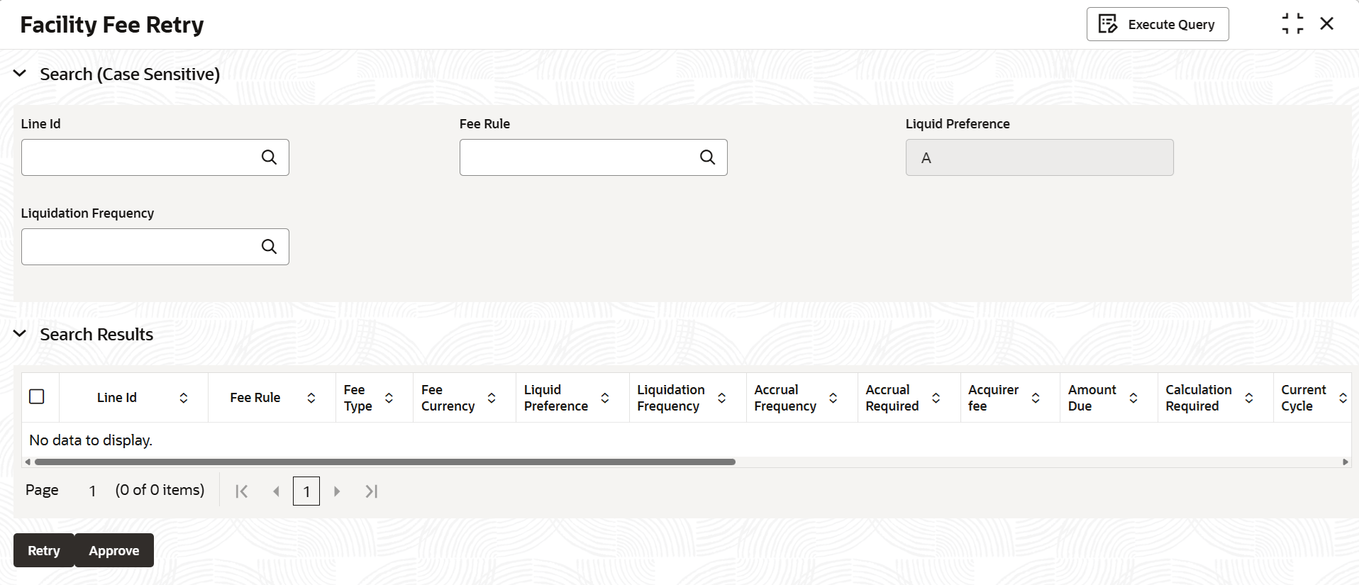

The Facility Fee Retry screen lists down the facility fees which are configured as auto liquidation and are rejected during ECA request or failed due to other reason, irrespective of ECA configuration.
The user can use this functionality Facilities Fee Retry to Approve / Retry the Rejected ECA request.
The fees rejected due to unavailability of funds can be re-triggered for liquidation once the balance is available in CASA of the customer and/or the fee that failed due to other reason can be retried for liquidation, by selecting the retry option.
The failed / rejected fees can be liquidated and force posted irrespective of available balance in CASA, by selecting the Approve option.

    The Facility Fee Retry screen is displayed. For more information on fields, refer to the field description table.

    Line Id Click the Searchicon and select the line ID to view the rejected / failed fees.
    Fee Rule Click the Searchicon and select the fee rule associated with a facility to view the rejected / failed fees.
    Liquidation Preference Click the Searchicon and select the liquidation preference based on fee rule to view the rejected / failed fees.
    Liquidation Frequency Click the Searchicon and select the liquidation frequency based on fee rule to view the rejected / failed fees.
