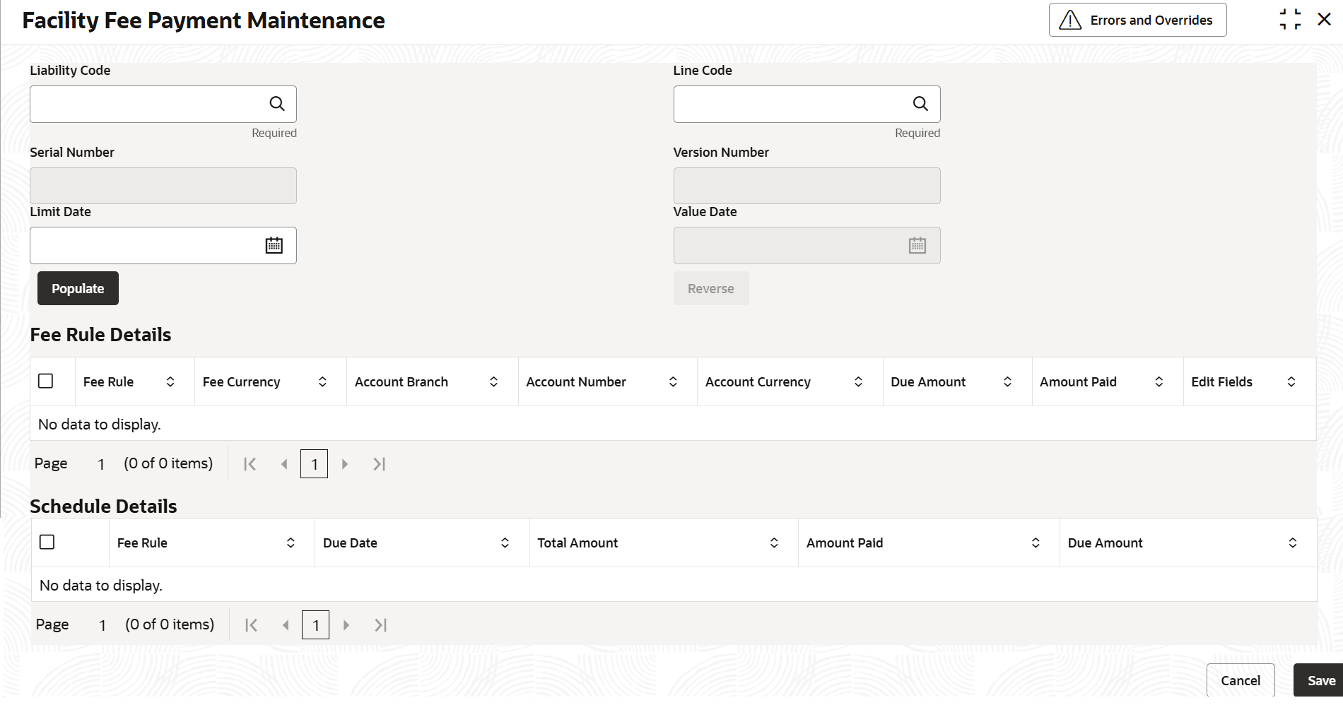

User can perform manual fee payment by selecting facility detail and limit date in the Facility Fee Payment Maintenance screen.
  1. On Home screen, select Limits and Collaterals. Under Limits and Collaterals, select Limits.
  2. Under Limits, select Maintenances. Under Maintenances, select Facility Fee Payment.
  3. Under Facility Fee Payment, select Facility Fee Payment Maintenance.
    The Facility Fee Payment Maintenance screen is displayed.
    Figure 1-61 Facility Fee Payment Maintenance
    Once you select the Liability Code, Line Code, and Limit Date, and click Populate, the Fee Rule Details and Schedule Details sections get displayed.
    The Serial No field is disabled, and it gets defaulted from the Facilities Maintenance screen.
    It shows the summary of amount due and amount scheduled for a particular fee starting from start date to limit date.
