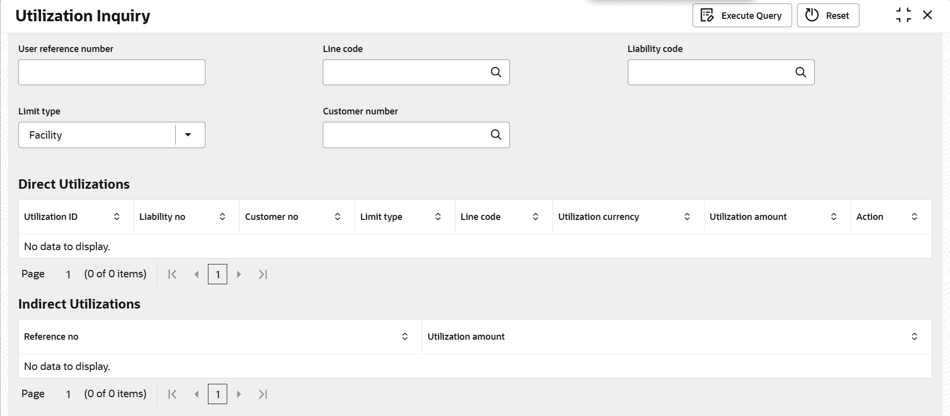

    The Utilization Inquiry screen displays.
    Figure 1-87 Utilization Inquiry
    You can select one or all the parameters and click on execute query option. System will display the result based on the search criteria(s). Click on the view option to view the details of the record. Inside the detail screen you have option as,
      • View Utilization log: You can view each of the transaction actions on the contract using this inquiry. This opens the common Utilization log Inquiry with filters (liability/facility) preselected and related results
