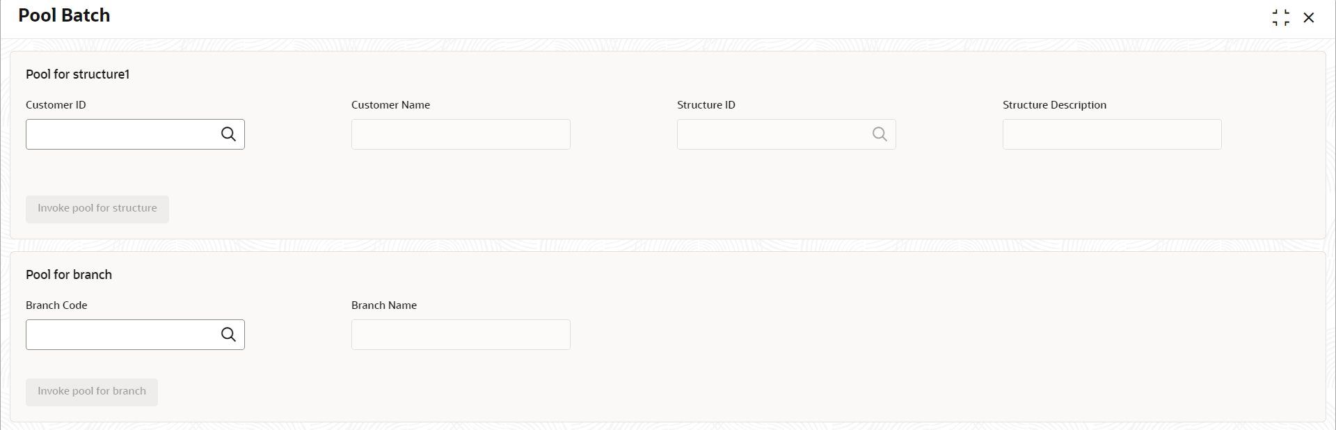

    The Pool Batch screen displays.
To Initiate Pool for Structure:
  1. Specify the fields on Pool for structure1 section in Pool Batch screen.
    The fields, which are marked with an asterisk, are mandatory.
    Table 9-32 Pool Batch_Structure – Field Description
    Field Description
    Customer ID Click Search icon to view and select the customer ID.
    Customer Name Displays the customer name based on the selected customer ID.
    Structure ID Click Search icon to view and select the structure ID.
    Structure Description Displays the structure description based on the selected structure ID.
  2. Click Invoke pool for structure to invoke the pool batch for the structure.
To Initiate Pool for Branch:
  1. Specify the fields on Pool for branch section in Pool Batch screen.
    Table 9-33 Pool Batch_Branch – Field Description
    Field Description
    Branch Code Click Search icon to view and select the branch code.
    Branch Name Displays the branch name based on the selected branch code.
  2. Click Invoke pool for branch to invoke the pool batch for the branch.
