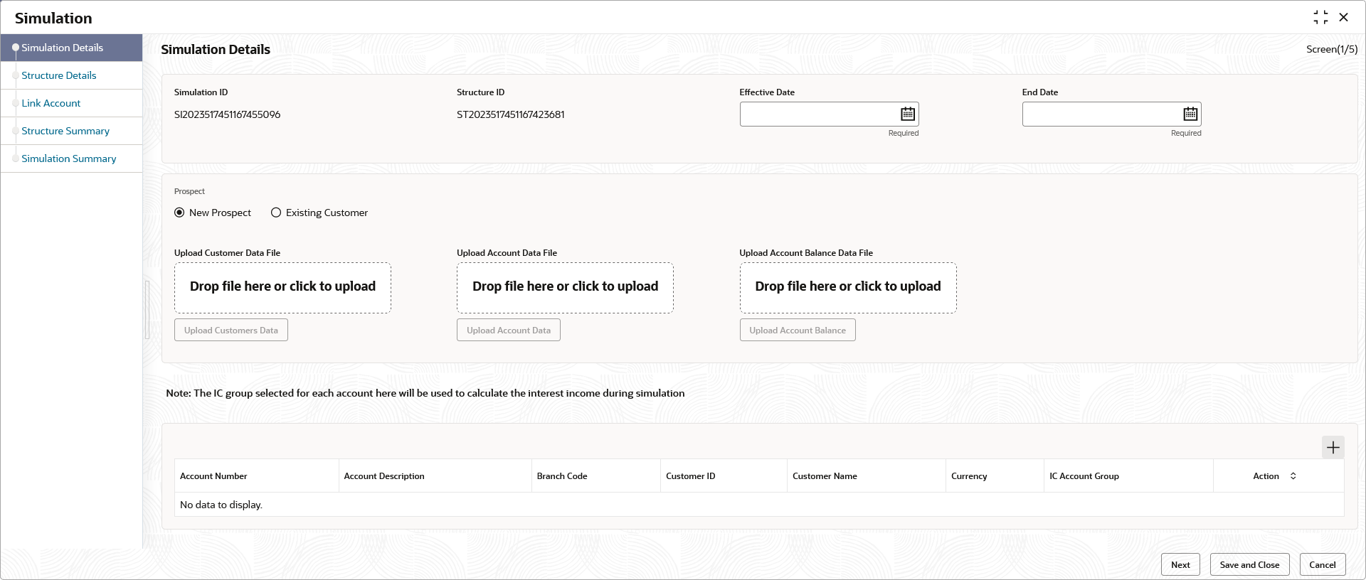

    Figure 12-2 Simulation Details - New Prospect

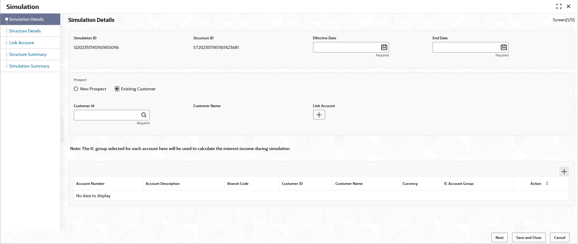

    Figure 12-3 Simulation Details - Existing Customer

    Prospect Select the type of prospect as New Prospect/ Existing Customer.
    Drop file or click to upload Click this button to browse and select the file for the respective file uploads.
    This field is applicable to New Prospect.
    Upload Customer Data Click this button to upload the customer data file.
    Upload Account Data Click this button to upload the account data file.
    Upload Account Balance Click this button to upload the account balance data file.
    Customer ID Click Search icon to view and select the customer ID from the list.
    This field is applicable to Existing Customer.
    Customer Name Displays the name of the customer based on the customer ID selected.
