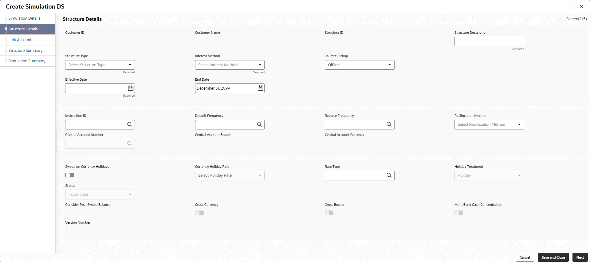

13.1.2 Structure Details
This topic describes the systematic instructions to update the structure details for creating a new structure.
  1. Click Next in the Simulation Details screen to update the Structure Details.
    The Structure Details screen displays.
  2. Specify the fields on Structure Details screen.
    The fields, which are marked with an asterisk, are mandatory.
    Table 13-3 Structure Details – Field Description
    Field Description

  3. Click Next to save and navigate to the next screen (Link Account).
  4. Click Save and Close. to save and close the details.
  5. Click Cancel to discard the changes and close the window.
